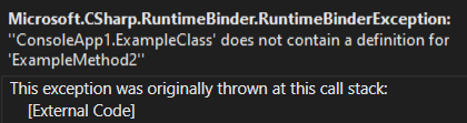

    I can repro your exception easily, either using .net 5 or .net 6 (probably core 3.1, .net 4.0 (C# 4) etc. as well)
    My app was running .Net 6 (with top-level statements which doesn't seem to matter)
    Downgrading to .Net Core 3.1 shows same message as yours in a similar case (argument name with "wrong" case)
    Using .Net 5 (C# 9 compiler) or .Net 6 (C# 10 compiler) does not show any error in my case.
