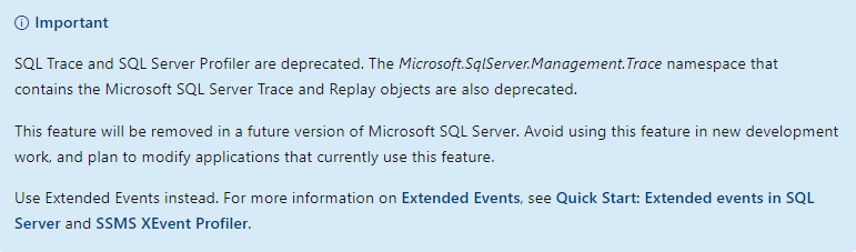

    Agree with pituach. Please see this official document about SQL Server Profiler: https://learn.microsoft.com/en-us/sql/tools/sql-server-profiler/sql-server-profiler?view=sql-server-ver15
    See this short article about Extended Events Vs Profiler Trace: https://www.mytecbits.com/microsoft/sql-server/extended-events-vs-profiler-trace

    You should use Extended Event for the task. This is the official documentation to get start on using extended event (try it):
    https://learn.microsoft.com/sql/relational-databases/extended-events/quick-start-extended-events-in-sql-server?view=sql-server-ver15&WT.mc_id=DP-MVP-5001699
