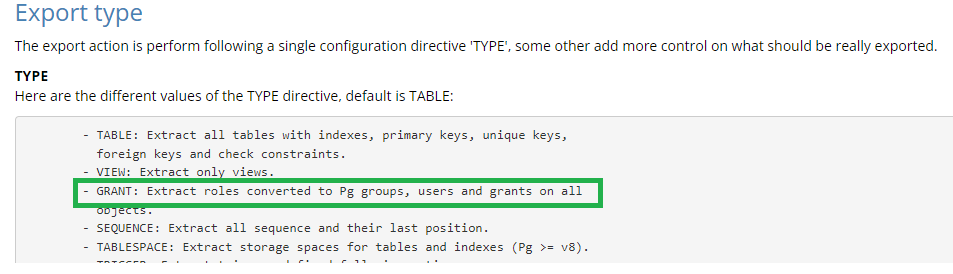

    Oracle users, roles, and grants to the Azure PAAS PostgreSQL database will be done automatically by ora2pg, if you use ./export_schema.sh it will export the whole schema together with roles and grants.
    you can refer to these documents Ora2pg Moves database to PostgresSQL, Oracle to Azure Database for PostgreSQL: Migration guide | Microsoft Learn
    Please let us know if this information helps.

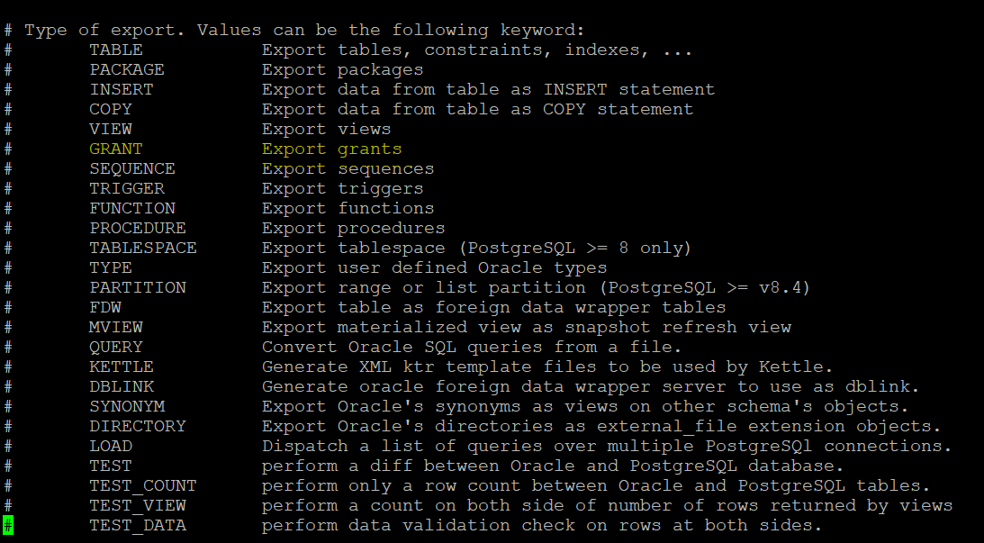

    My configuration file looks different than what you have shared, In my config file grant means it is just showing as Export grants but in yours it is showing as Export roles converted to Pg groups, users and grants on all objects.
    Can you please let us know where we are missing here. PFB
    Type of export. Values can be the following keyword:
    TABLE Export tables, constraints, indexes, ...
    PACKAGE Export packages
    INSERT Export data from table as INSERT statement
    COPY Export data from table as COPY statement
    VIEW Export views
    GRANT Export grants
    SEQUENCE Export sequences
    TRIGGER Export triggers
    FUNCTION Export functions
    PROCEDURE Export procedures
    TABLESPACE Export tablespace (PostgreSQL >= 8 only)
    TYPE Export user defined Oracle types
    PARTITION Export range or list partition (PostgreSQL >= v8.4)
    FDW Export table as foreign data wrapper tables
    MVIEW Export materialized view as snapshot refresh view
    QUERY Convert Oracle SQL queries from a file.
    KETTLE Generate XML ktr template files to be used by Kettle.
    DBLINK Generate oracle foreign data wrapper server to use as dblink.
    SYNONYM Export Oracle's synonyms as views on other schema's objects.
    DIRECTORY Export Oracle's directories as external_file extension objects.
    LOAD Dispatch a list of queries over multiple PostgreSQl connections.
    TEST perform a diff between Oracle and PostgreSQL database.
    TEST_COUNT perform only a row count between Oracle and PostgreSQL tables.
    TEST_VIEW perform a count on both side of number of rows returned by views
    TEST_DATA perform data validation check on rows at both sides.
    TYPE TABLE,COPY,VIEW,GRANT,SEQUENCE,TRIGGER,PROCEDURE

    I have tried the document which you have provided but in vain. I'm attaching the config file and grants file which generated for your reference.
    188278-ora2pg-conf.txt
    Grants output: (not able to attach more than one attachement, so pasting it)
    [root@databasepocserverrep grants]# cat grant.sql
    -- Generated by Ora2Pg, the Oracle database Schema converter, version 23.0
    -- Copyright 2000-2021 Gilles DAROLD. All rights reserved.
    -- DATASOURCE: dbi:Oracle:host=databasepocserver;sid=orapgdb;port=1521
    SET client_encoding TO 'UTF8';
    \set ON_ERROR_STOP ON
    -- Nothing found of type GRANT
  5. Velmurugan 1 Reputation point
    2022-03-30T08:01:49.16+00:00
    @GeethaThatipatri-MSFT
    Still I didn't receive the answer why my config file type is looking different than yours? if you look at the attachment, grans are showing just export grants.
