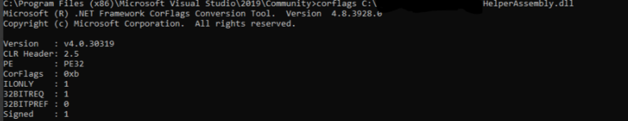

Then I have enabled the debug logs in my .NET core profiler. The below line of code has the problem. (il_writer.cpp, 636)
Please help me why this line of code gives the problem.
![186417-capture.jpg][2]
NOTE: My Helperassembly.dll builds in AnyCPU architecture. [2]: /api/attachments/186417-capture.jpg?platform=QnA

    It seems that you're encountering a System.BadImageFormatException with HRESULT 0x80131192 when profiling a 32-bit .NET Core application hosted in IIS. This error typically means there's a mismatch between the architecture of the process and the DLL being loaded — for example, trying to load a 64-bit DLL into a 32-bit process or vice versa.
    In your case, the crash occurs during classic-style instrumentation via SetILFunctionBody, which is sensitive to both the architecture and the validity of the IL being injected. Let's do a recap:
    • The error typically occurs when a 32-bit process tries to load a 64-bit DLL. Please ensure that both ClrProfiler32.dll and HelperAssembly.dll are explicitly compiled for x86. Even though HelperAssembly.dll is built as AnyCPU, it may still fail in a 32-bit process if it contains native code or platform-specific dependencies.
    • The crash in your profiler code at:
        IfFailRet(m_pICorProfilerInfo->SetILFunctionBody(m_moduleId, m_tkMethod, pBody));
      suggests that the IL being injected might be malformed or incompatible with the method’s metadata. This API is sensitive to both the correctness of the IL and the runtime environment.
    • Your profiler DLLs may rely on specific versions of the Visual C++ Redistributable. If these are missing on the server, the profiler might fail to load properly due to missing dependencies.
    You can try:
    1. In Visual Studio, ensure both ClrProfiler32.dll and HelperAssembly.dll are compiled for x86:
    • Project PropertiesBuildPlatform targetx86
    Guide: https://learn.microsoft.com/en-us/visualstudio/ide/how-to-configure-projects-to-target-platforms
    1. Install Visual C++ Redistributable (x86)
    Download: https://learn.microsoft.com/en-us/cpp/windows/latest-supported-vc-redist?view=msvc-170
    1. If you're comfortable with deeper diagnostics, you can use tools like:
    • CorFlags to inspect DLL architecture
    • Fusion Log Viewer (Fuslogvw.exe) to trace assembly binding issues
    These are optional and not required for most setups.
