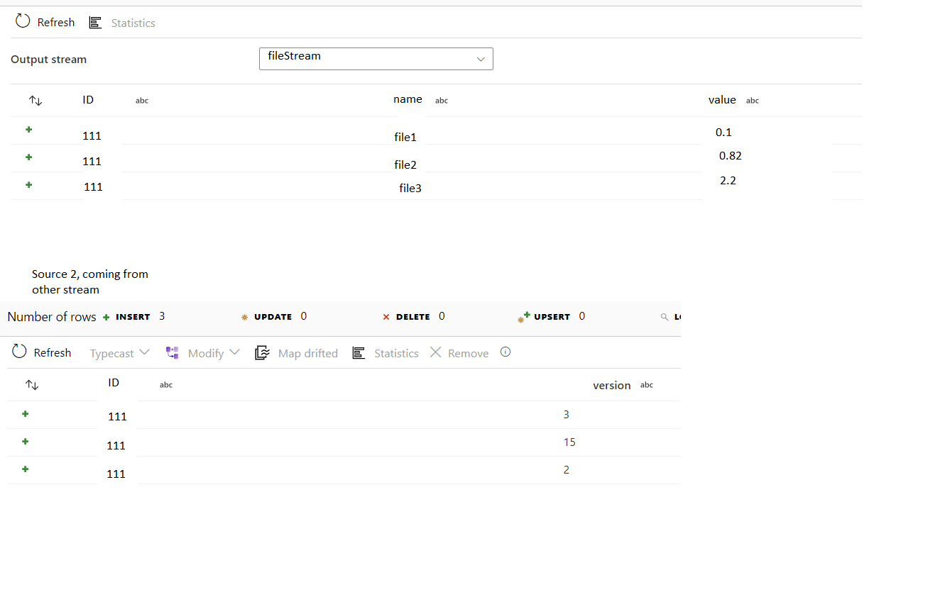

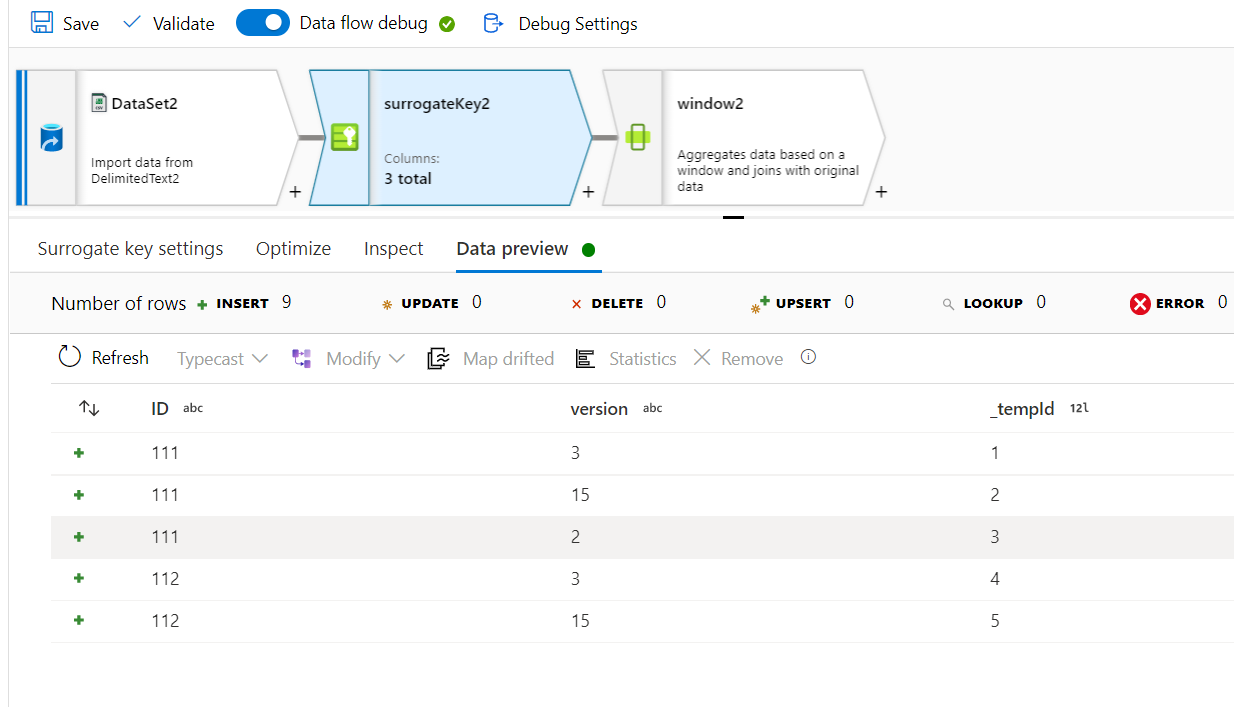

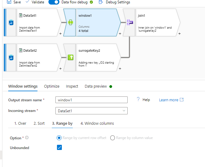

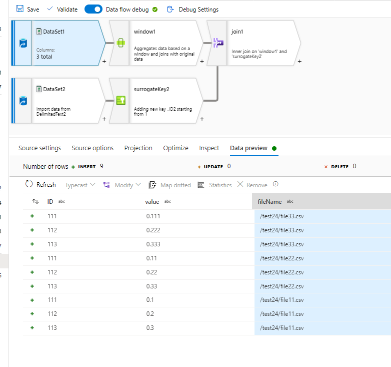

I have two sources resulting from some transformation in data flow:

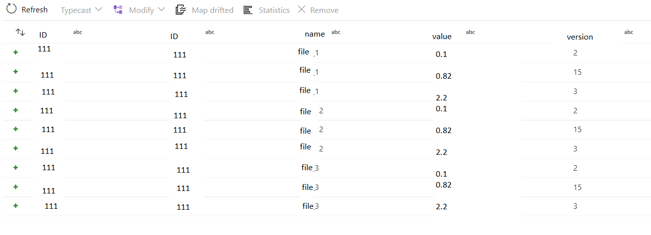

I have tried using join, it replicates the data no matter join I select it outputs similar stuff:
I have tried union as well but union either creates null in columns (if done by name) or rows (if done by position)
SHouldnt the jojn just concat the columns together beacuse the IDs are same in both table.

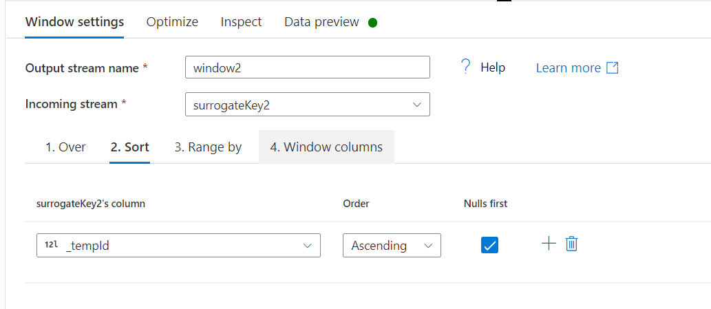

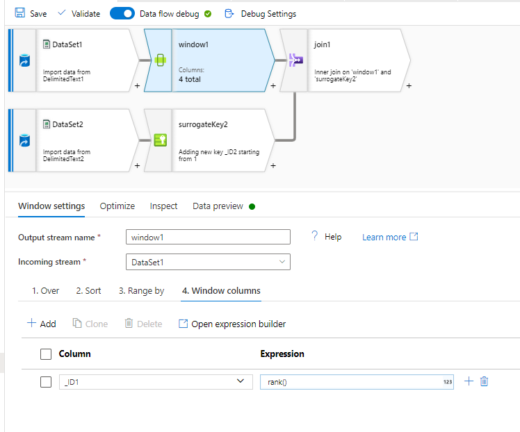

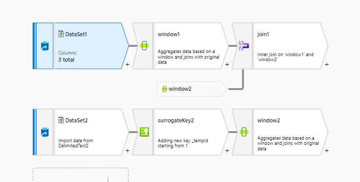

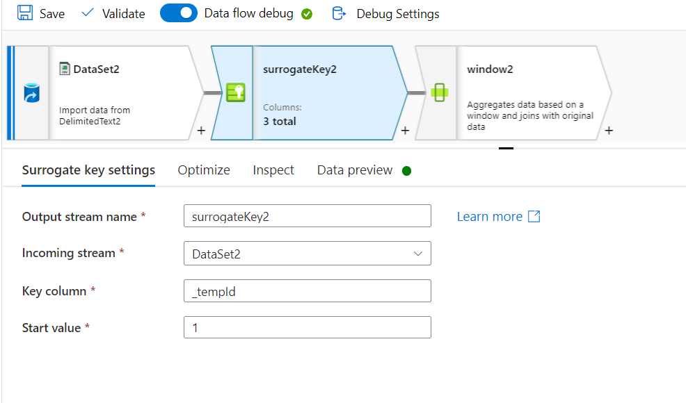

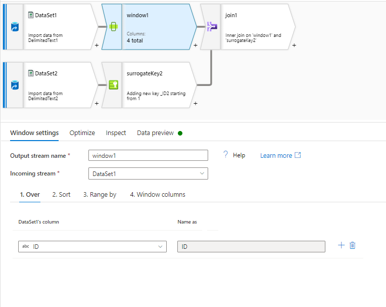

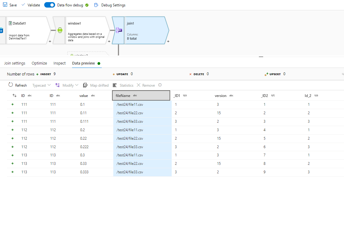

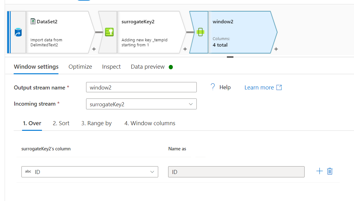

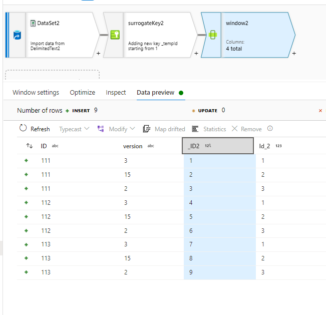

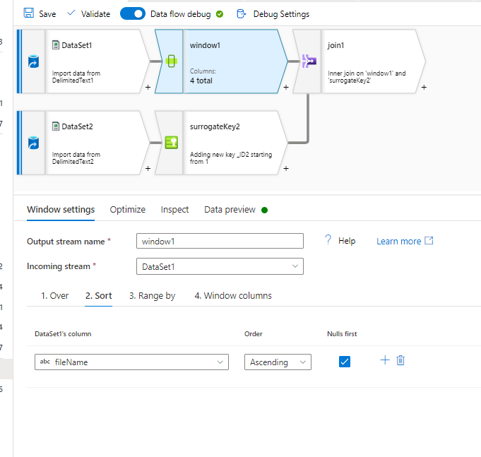

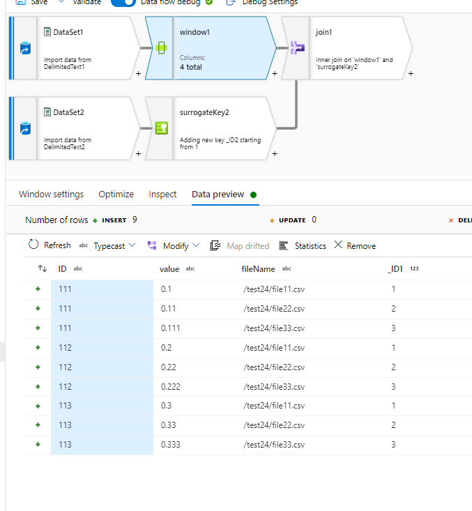

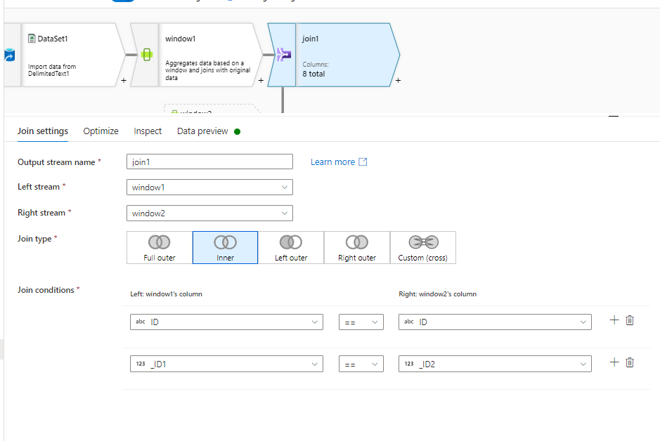

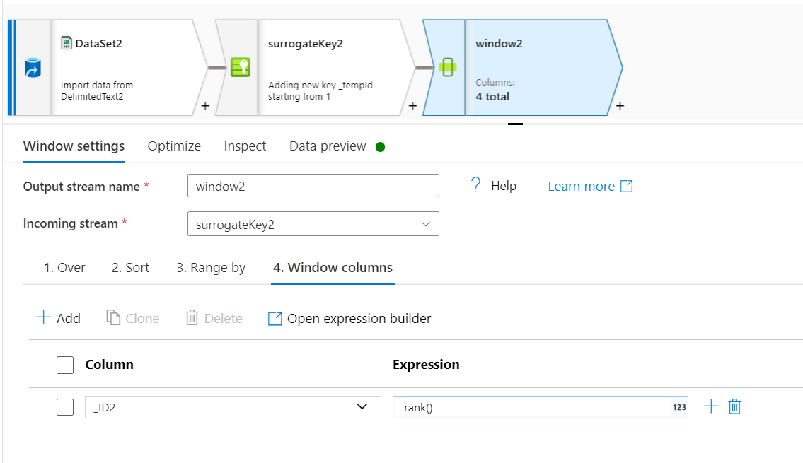

    Thank you for the ask. As you are joining by ID, that was the expected/correct output you were getting. Main problem here is, the Dataset2 with version does not have any indication which value should be considered for which ID+file. What you can do here:
    Note: I have edited the comments: final output would be something like the foloowing:
    -for Dataset2, add SurrogateKey --> WINDOW
    Hope this helps, thanks! :)
