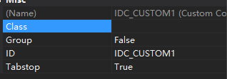

The attached sample program has an incomplete dialog window. It's just to demonstrate a custom edit control.
The dialog has two edit controls. One is a custom control derived from CEdit, and the other is a regular CEdit control. The regular control shows up.
I tried adding OnDrawItem after modifying the style to be owner-drawn, and that method is call. It's still not displaying anything. That code is currently commented-out.
I'm not sure what is wrong. I suspect it might be the wrong rectangle when I create the window, although I've played with that to no avail.
I have looked at the CTRLTEST Microsoft example.
Note, the commented-out OnDrawItem method in the dialog class is to draw a button, and the code was copied from a codeproject project. I just wanted to see something displayed.
I have code in a zip file to upload. Hopefully a way to upload that code will appear after I submit this question.

    The initial code had several issues. I made a number of changes to get it working and inserted some comments. In addition to the use of the custom control in the dialog template I also showed creating it dynamically in the application's About dialog.
    The revised VS2022 solution can be obtained from OneDrive at https://1drv.ms/u/s!AmnqrCFBv4nDgh-jPL4Fd335LpQm?e=pobJts

    I changed the RegisterClassWindow function to a static function before sending the code, and forgot to change the calling sites. I feel stupid about that.
    Otherwise, I had no idea how to solve this. I didn't realize the needed modification to the RegisterClassWindow function, nor did I realize that OnCtlColor would not be called. I did use reflection with controls a very long time ago. I've forgotten most of that.
