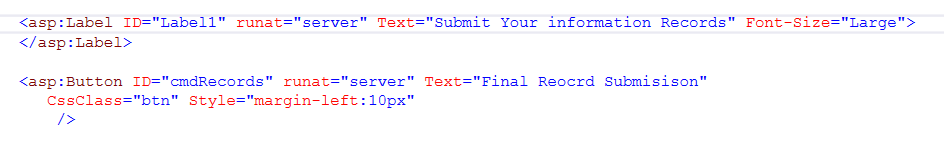

    eg this:
    Ok, so that looks like this:
    And code behind for that button is whatever you had/have now.

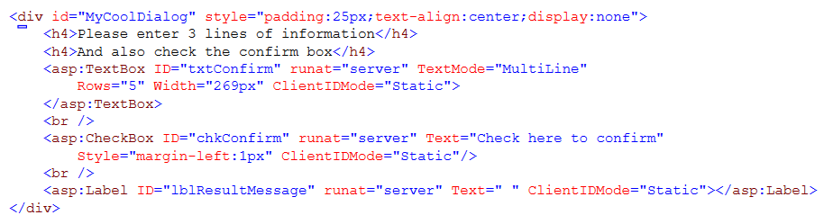

    Ok, so this dialog system works by you laying out the dialog (to popup) in a div. We drop in our text box, and a check box. (and a label to display the error message if/when the "ok" button fails).
    So, that looks like this:

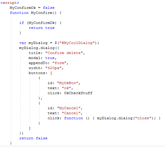

    So, that button will call our JavaScript code - that pops the dialog
    that code is this:
    So, that code will pop the dialog, and when you hit "ok" button, it calls some code behind (a web method - so no post-back).
    And as above shows the ok button will call that code + routine to run the server side code.

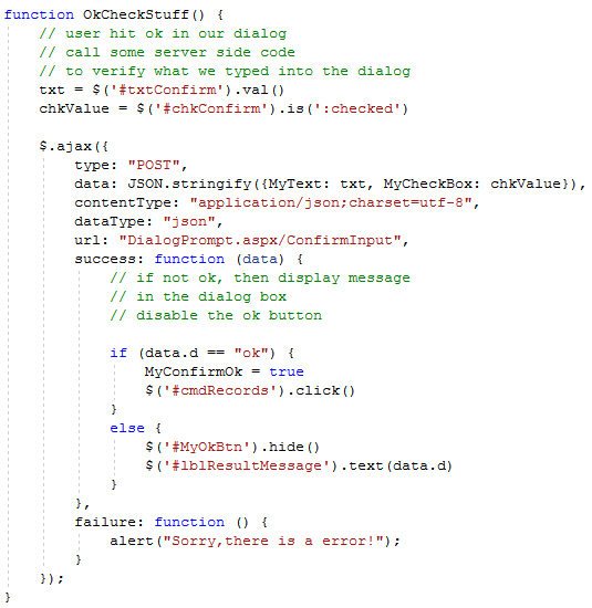

    that JavaScript code is this:
    Our code behind is thus this:

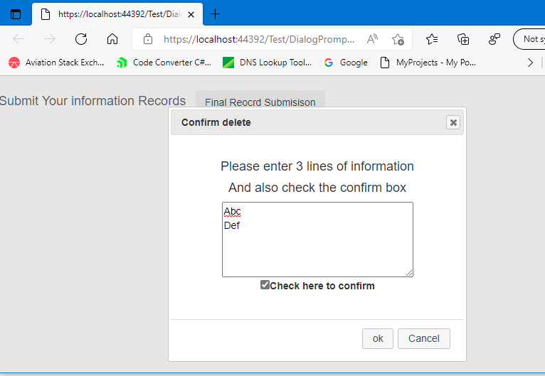

    So, this now looks like this:
    Now, in above, I did not enter 3 lines of text, so when we click ok, we get this:
    So, the "ok" button is disabled (or hidden - don't matter). So at this point, the only option is to hit cancel.
    However, if we do enter the required information (determined by that code behind on the server), then of course hitting ok will trigger the original button and code behind.
