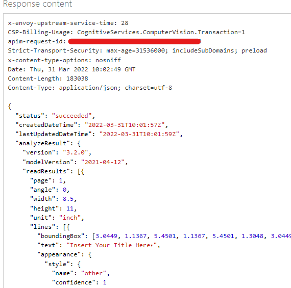

    UPDATE:
    Below call to pass the local file should also work, the error in this case seems to be with the parameter as mentioned in further comments below:
    curl --location --request POST "https://<your-resource>.cognitiveservices.azure.com/vision/v3.2/read/analyze?readingOrder=basic" --header "Content-Type: application/octet-stream" --header "Ocp-Apim-Subscription-Key: <your_key>" --data-binary "@/C:\\Users\\test\\Documents\\interim-layout.pdf"
