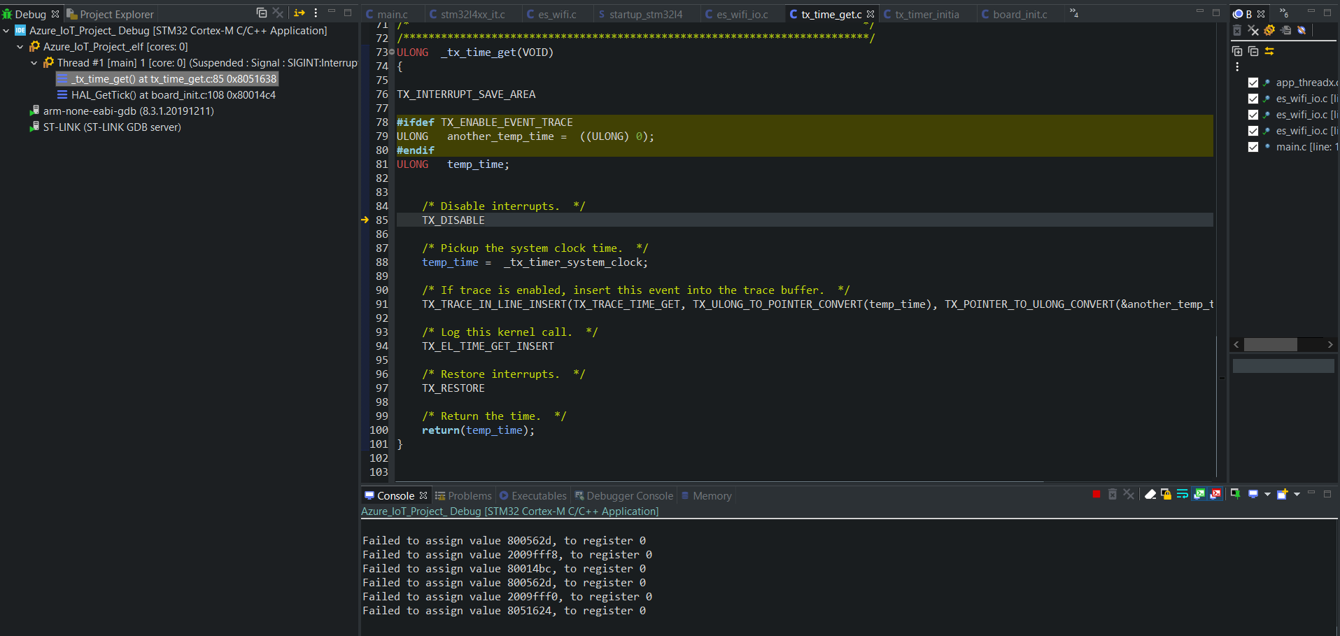

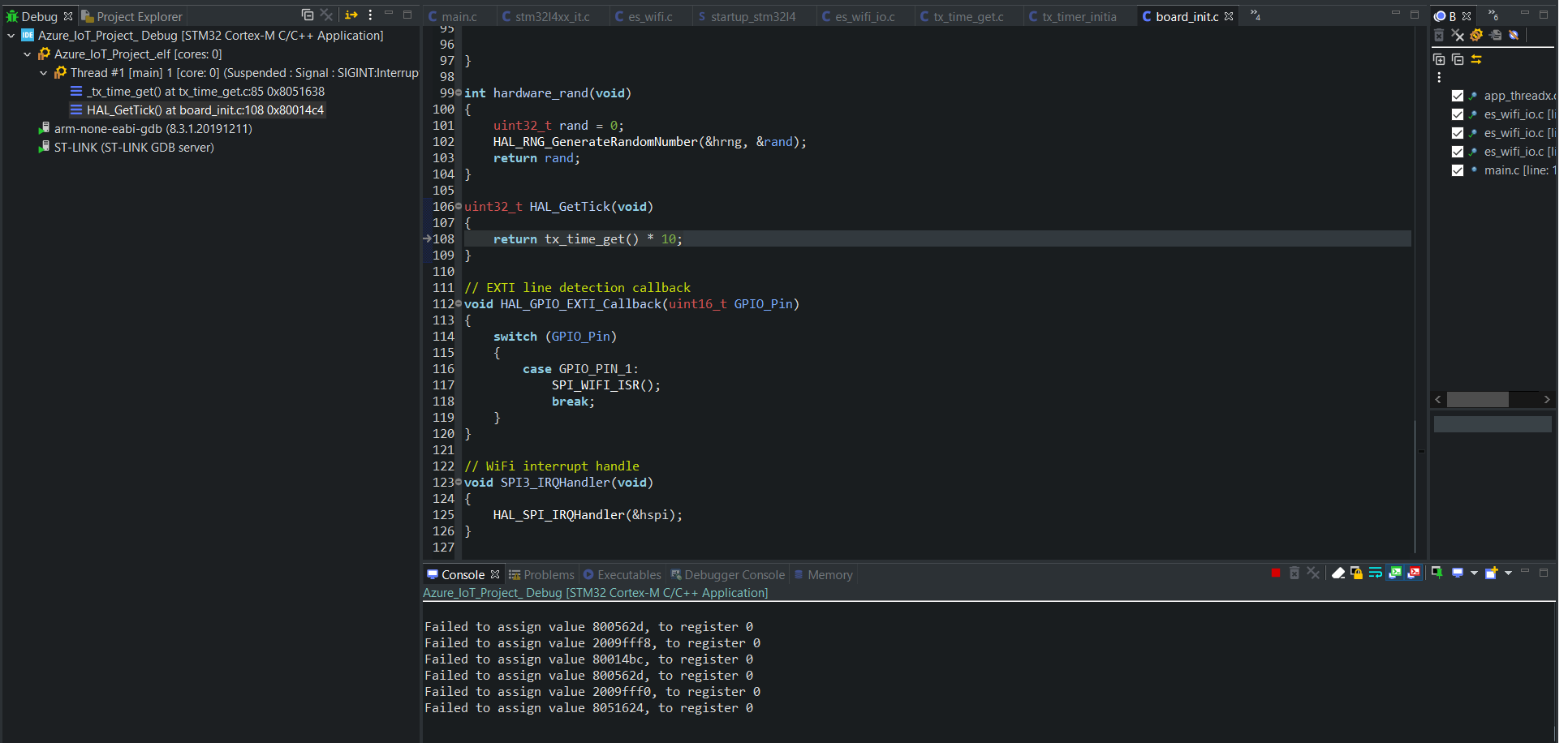

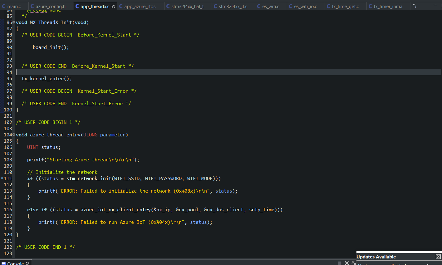

I am trying to implement an example of sending data from B-L4S5I-IOT01A board sensors to Azure IoT Central via telemetry to Stm32CubeIDE and I almost succeeded but I have a problem with Systick because there are no interrupts from Systick in the Wifi initialization function. I tried to change the Systick to a different timer like TIM6 but that only made things worse. I tried to add Wifi initialization before AzureRTOS initialization and in tx_thread_entry but I also have the same problem. Anyone else have any ideas or would like to debug the code?

    it seems that the "HAL_InitTick" is not setup successfully.
    please take the file here as a reference how to redefine "HAL_InitTick" :
    https://github.com/azure-rtos/getting-started/blob/master/STMicroelectronics/B-L4S5I-IOT01A/lib/stm32cubel4/Drivers/STM32L4xx_HAL_Driver/Src/stm32l4xx_hal_timebase_tim_template.c
