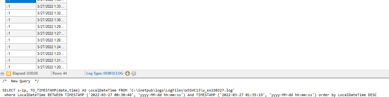

    Hi @Ou Cop ,

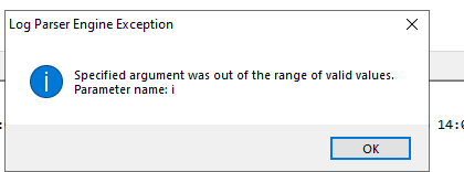

    I made some modifications to your query to fit my log. My log file doesn't have LocalDateTime so I change it to s-ip. I also removed into OUTPUT.CSV because there's another issue. I'm not sure if you have same issue. But it can work after remove it.
    If you also have this issue, try to remove into OUTPUT.CSV .

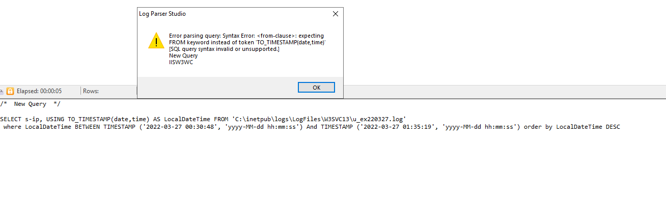

    So the issue is caused by USING TO_TIMESTAMP(date,time). If you want to use TO_TIMESTAMP function, just use it and no need to add USING.
    Same error with you.
    But it worked well after I removed the USING.
