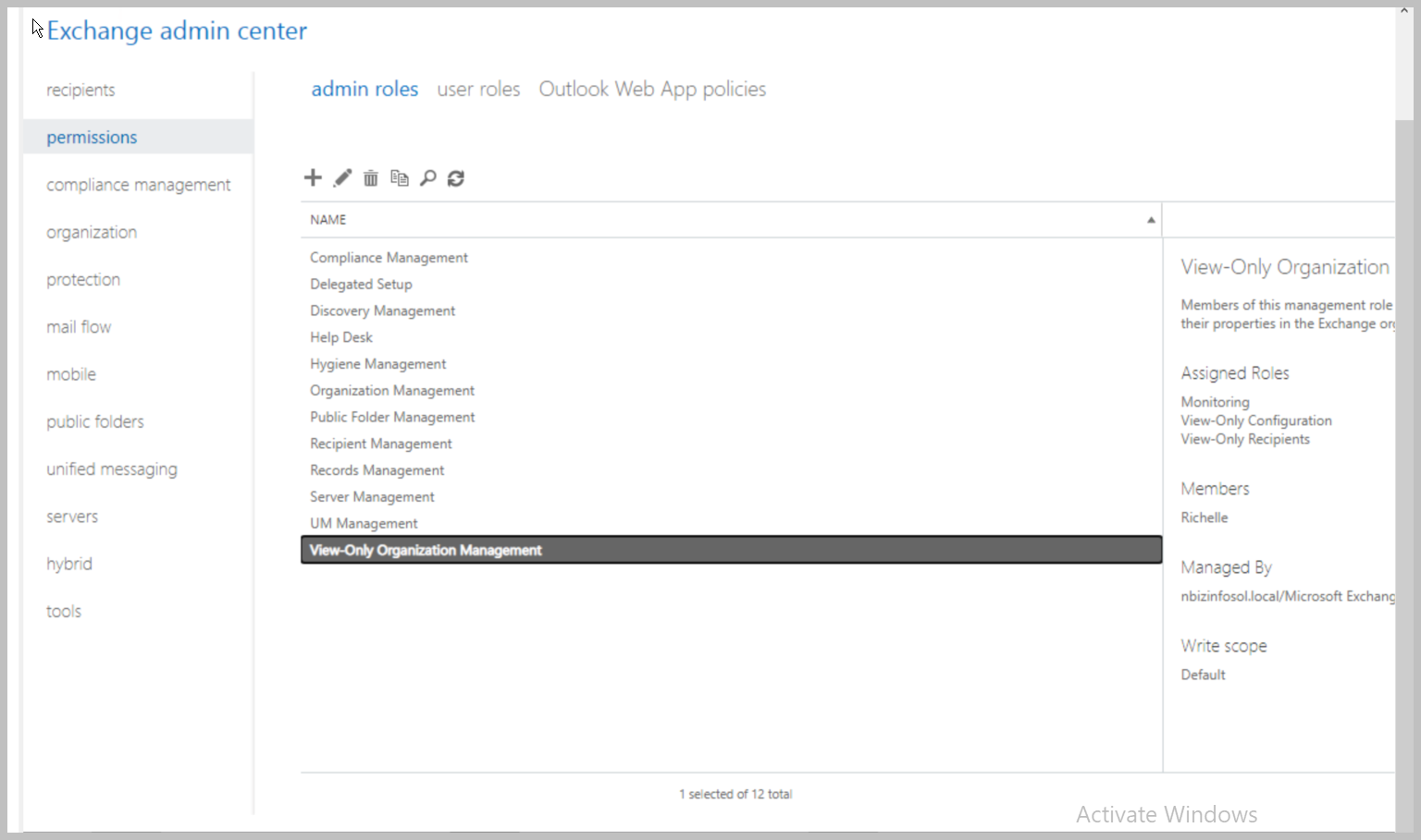

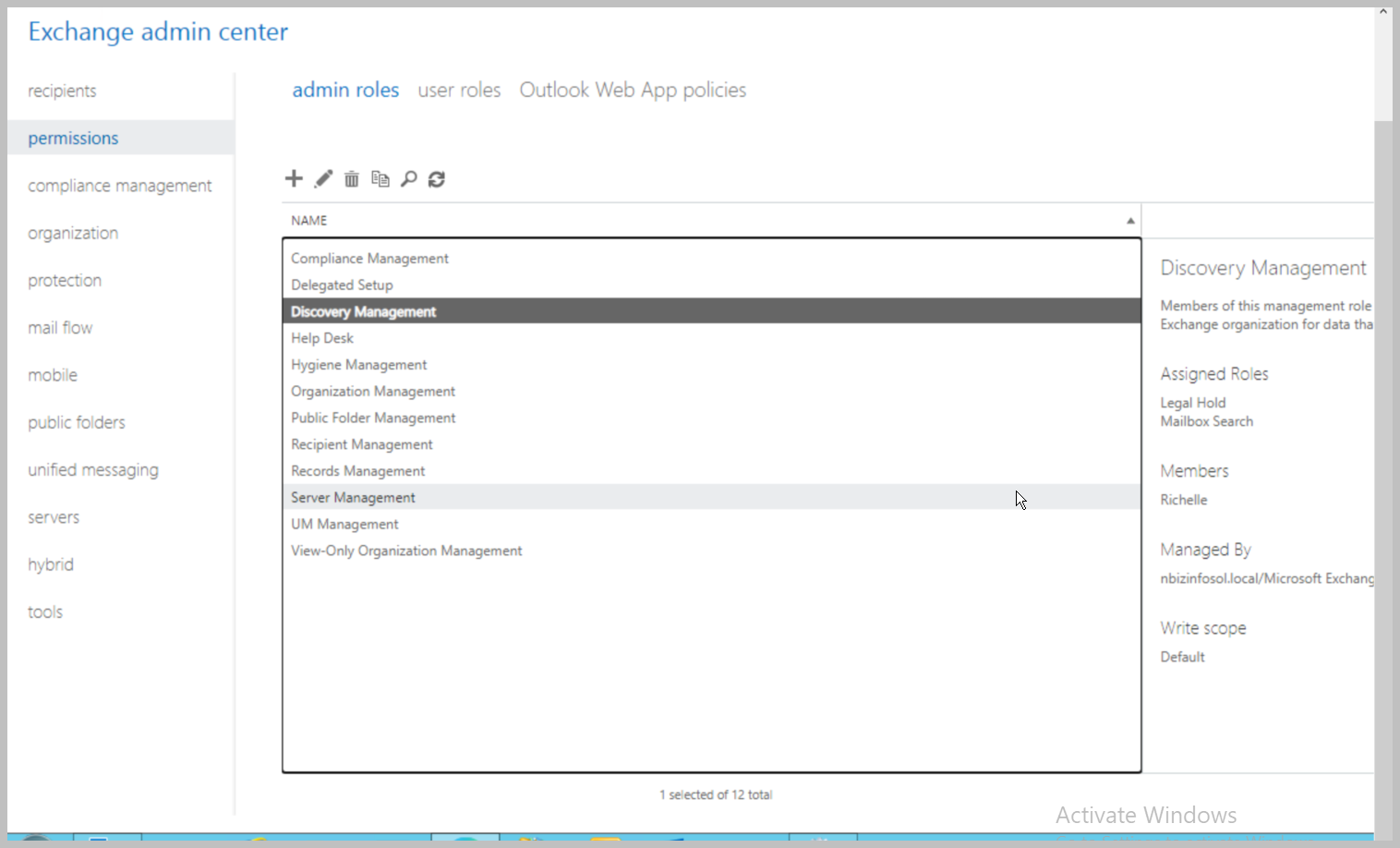

  4. Bhavani suresh 0 Reputation points
    2024-01-25T07:54:16.67+00:00
    Hello Team i want to add this point when i researched. On exch 2013 give users the permissions on discovery management. I think htis is the most logical step so that the users when you set up their profile in outlook, will discover their address and other information. i also gave view only orgnisation management as in 2nd image below but i dont think this is relevant. I did both steps just to check if the eror is disappeared..so the error was not there and the profile was setup. User's image
