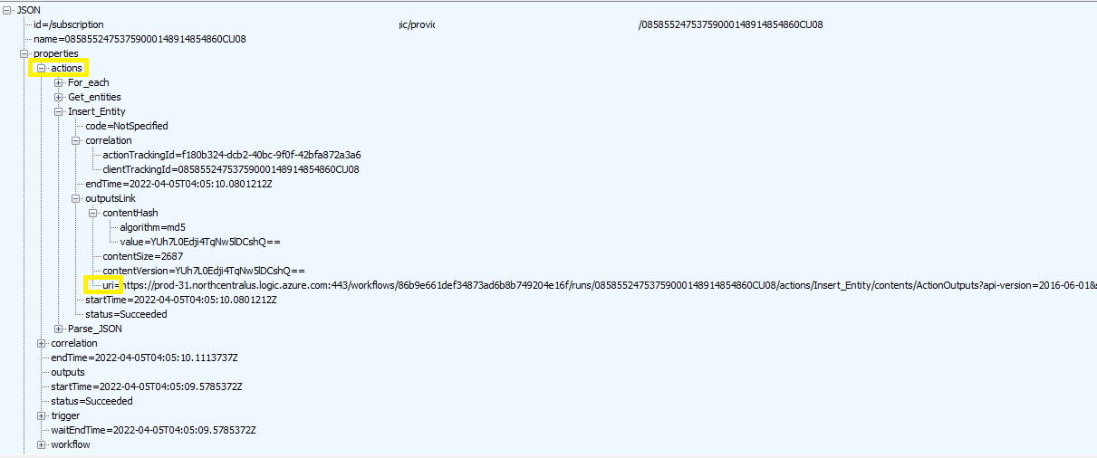

    The Get workflow run REST API along with $expand query parameter will list all the actions/trigger. You will find the uri property for your action/trigger inside the inputsLink/outputsLink property as below.
    Now you can make an HTTP request call on the uri parameter to get the actual JSON value input/output for action/trigger. You need to review the JSON return from the uri response to get the actual content.
