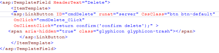

    Say we have this grid view with a delete button
    So, our delete button in the grid view is this:

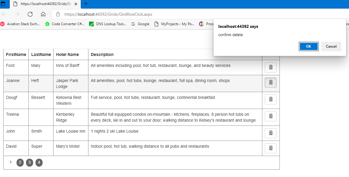

    So, if we click on that button, then the confirm dialog pops up - the default built in one. As above shows - not very pretty at all.
    And the code behind for that delete button is quite simple:

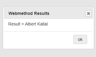

    Now, lets do the same with jQuery.UI dialog.

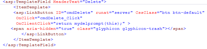

    The button code becomes this:
    Once again, like all asp.net buttons - if the onclientclick returns true, then the button runs, else if we return false, the button does not fire (run server side code behind).

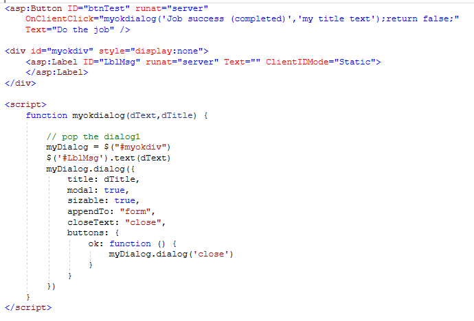

    So, with jQuery.UI, we use a div for the popup, and have this div and code now:
    Now, when I hit delete button, the dialog is custom - and very nice:
    And it even "darkens" the rest of the screen. So, consider grabbing a dialog utility. There are number, but the above is a jQuery.ui example to give you an idea of what they look like.
