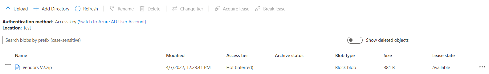

    Even if work with single zip file also same issue in webactivity, below is the scenario which i have tried for the csv file.
    this is my zipped csv file from source container.

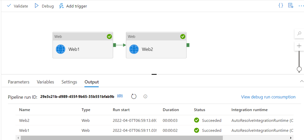

    here is the pipeline running with zip file and putting it inti destination.

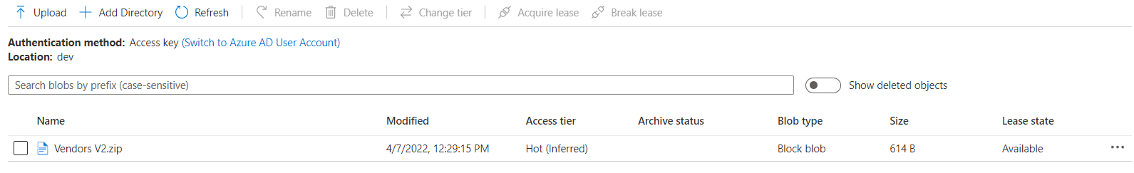

    after put into in destination container dev
    once i have downloaded and unzipped i am getting below error
    I am trying to do just lift and shift from one container to another but after putting same zip file is not able to unzip and getting error with invalid zip.
