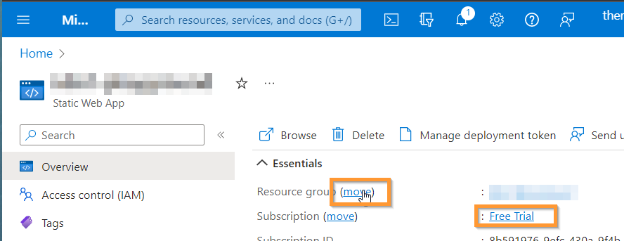

  3. io_out 0 Reputation points
    2023-09-12T06:21:40.87+00:00
    I didn't touch anything for several weeks and suddenly I start getting 404 as well...
    Solve it by upgrading my subscription to "pay as you go".
    There was message in subscription:
    "Your free credit has expired. Upgrade to keep going with your account."
