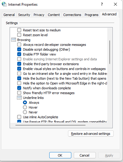

Dear experts,
We ran into an issue with the pop-up window of Script error message. I googled around but didn't find an option not to display these message via Internet Option. I'm using Win 11.
Anyway we can disallow these windows to show up? If yes, can we do it via Group Policy and is there any impact not to display the message?
Thanks a lot. I attached screenshots for your reference.

  1. Eaven HUANG 2,191 Reputation points
    2022-04-11T01:53:11.37+00:00
    Dear @@CmdrKeene ,
    Thanks for the information shared.
    I've worked it out via SCCM console. Actually I just need to enable "Display custom tabs with Microsoft Edge WebView2 runtime" so it displays as expected.
