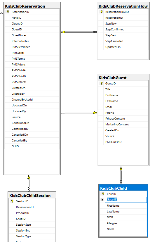

I have 3 tables (1 reservation can have a primary KidsClubGuest and one KidsClubGuest can have multiple KidsClubChild).
  1. KidsClubReservation
  2. KidsClubGuest
  3. KidsClubChild
I am trying to find a suitable select statement which displays all the KidsClubChild rows where ReservationID = 354 for example.

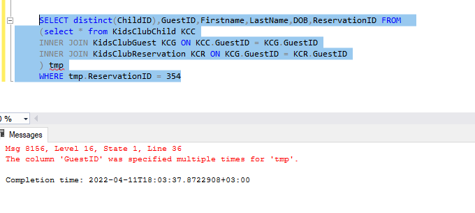

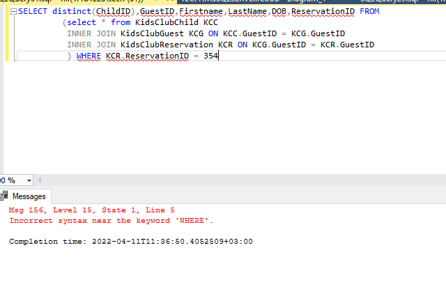

    SELECT distinct(KCC.ChildID),GuestID,Firstname,LastName,DOB,ReservationID FROM
    (select * from KidsClubChild KCC
    INNER JOIN KidsClubGuest KCG ON KCC.GuestID = KCG.GuestID
    INNER JOIN KidsClubReservation KCR ON KCG.GuestID = KCR.GuestID
    )temp
    WHERE KCR.ReservationID = 354
    As naomi said, you might as well try to modify the design of diagrams. You are using the correct multi-table connection, but there is only a problem in the data connection process.
    You did not provide us with some test data, we can only Try to modify the join condition according to your description. If this doesn't work, please provide some data for us to test this against.

    Yes I think my design is wrong then...

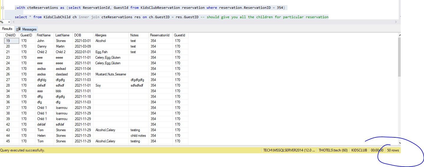

    I tried what you suggested but I am still getting all the kids where GuestID is 170 and this results in 50 records. Because the idea of this is to retrieve only the kids associated with reservation ID 354.
    So if I have another reservation e.g 355 and GuestID is 171 and that guest has 2 children associated with the reservation 355 then I should be able to retrieve only those 2 children. Now if the same guest with GuestID 171 makes another reservation e.g 356 and ads only one child then I should be able to retrieve that child only by searching with ReservationID 356.

    Do you need kids in a particular session? For your reservation 354, there is guestId 170 and all kids seem to have 170 as their guest, so your result is not surprising. How exactly do you get 3 kids only? What would you get if you try
     ;with cteReservations as (select ReservationId, GuestId from from KidsClubReservation reservation where reservation.ReservationID = 354)
     select ch.* from KidsClubChild ch
    where exists (select 1 from
    cteReservations res where ch.GuestID = res.GuestID) -- should give you all the children for particular reservation under same guest ID

    Full query would be:
    select * from KidsClubChild ch inner join cteReservations res on ch.GuestID = res.GuestID -- should give you all the children for particular reservation
