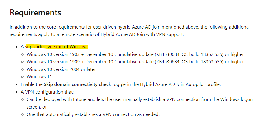

    @Leonard Gilbert , For the error code, it seems to be with Offline Domain join issues. From your description, I know we are using Windows 10 1809. Based as I know, for User-driven mode for hybrid Azure Active Directory join with VPN support , the device needs to be with the following supported version.
    https://learn.microsoft.com/en-us/mem/autopilot/user-driven#user-driven-mode-for-hybrid-azure-active-directory-join-with-vpn-support-preview
    Given the situation, we suggest to upgrade the device to the supported version for our scenario and see if it can work.
