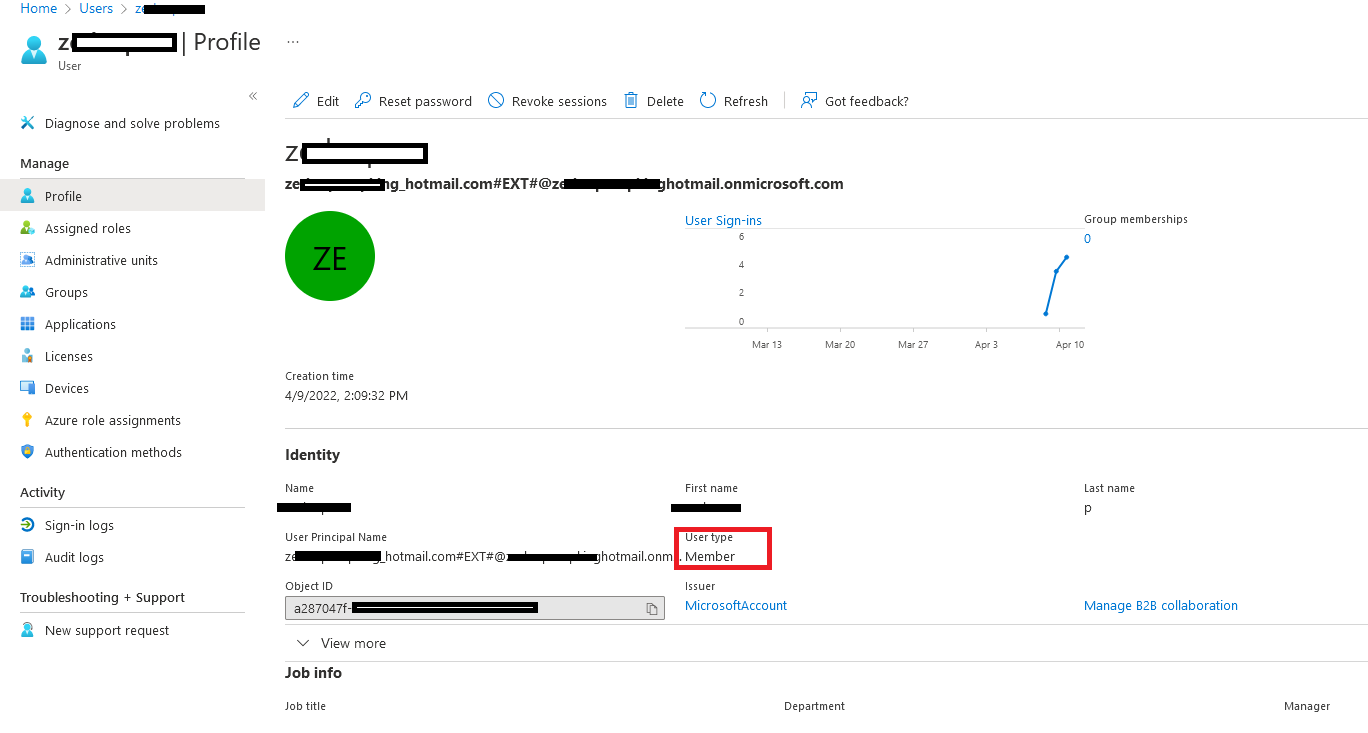

    I've spent an afternoon researching it and can conclude: the /calendars endpoint does not support invited guest users, only work accounts registered through the tenant, you can use a postman test to confirm this.
    By the way, the /events endpoint also doesn't support invited guest users, the reason why you call successfully in graph explorer is because he represents the member login of the original tenant, you can call the /me endpoint to see the user id, it should be different from the user id in the current tenant. Because it is actually two identities, one is the member identity of the original tenant, and the other is the guest identity of the current tenant.

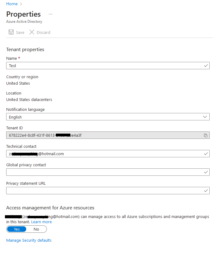

    This is because your permissions have not been granted admin consent, so the token does not contain any permissions. You'll need to run the admin consent URL in the browser, then have your global administrator log in and consent on behalf of the organization.
    https://login.microsoftonline.com/{tenant-id}/adminconsent?client_id={client-id}
