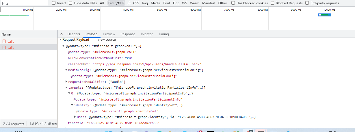

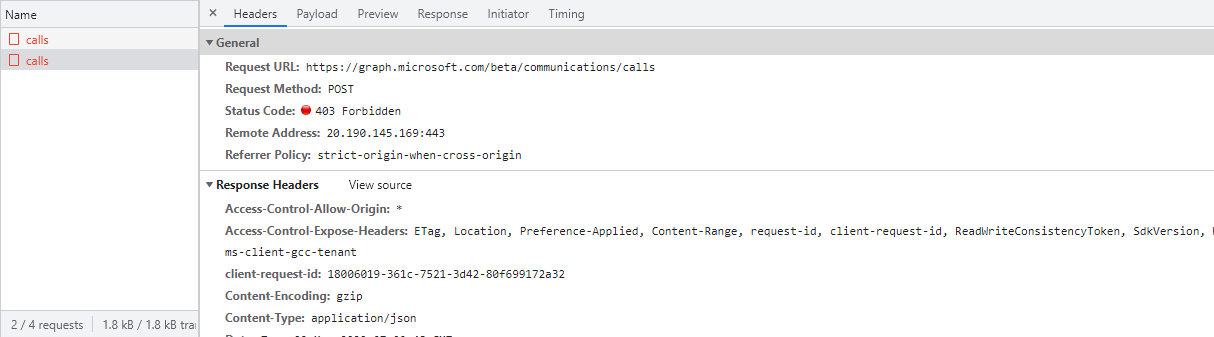

I am trying to make call using Microsoft Geaph API to teams with Azure Bot registration with Teams Channel enabled. When I am trying to call it's saying Request Authorisation tenant mismatch.
I tried support,Stack overflow and this is the last option left as nothing is working for me and MS is not even responding to the issue
Below are the deetails
   call =
           "@odata.type": "#microsoft.graph.call",
           "direction": "outgoing",
           "subject": "Call for Expert from Helpaas User",
           callbackUri: 'https://api.helpaas.com/v1/api/users/handleCallCallback',
           "targets": [
               "@odata.type": "#microsoft.graph.invitationParticipantInfo",
               "identity": {
                 "@odata.type": "#microsoft.graph.identitySet",
                 "user": {
                   "@odata.type": "#microsoft.graph.identity",
                       displayName : id.DisplayName,
                       "tenantId": "1b5002d5-a18c-4575-858e-f07acdb7cb58"
           "requestedModalities": [
             "audio"
           "mediaConfig": {
             "@odata.type": "#microsoft.graph.serviceHostedMediaConfig",
             "removeFromDefaultAudioGroup": false
         const response = client.api(`/communications/calls`)
         .post(call);
         response.then(call=>{
             console.log("Call data--->> CAll ",call)
             // call.on
         }).catch(err=>{
             console.log("Eroor getting call data",err)
NOTE : Below are the details along with images
  • Teams calling is enabled and shows status as healthy in the Azure Bot configuration.
  • Cross checked Application token that it is in the same tenant i.e Tenant ID in the application token is same.
  • All the permission that are mentioned have been provided as per call.
