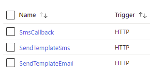

I have an Azure Function named "SendTemplateEmail" that has an HTTP Trigger.

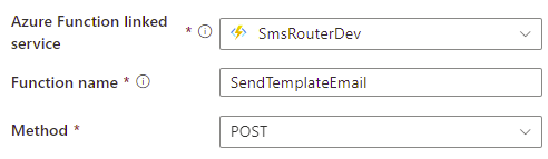

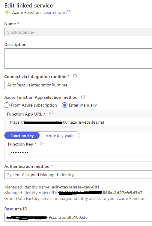

I've created a new linked service and configured as follows:
I've configured the Azure Function task within the ADF Pipeline as follows:
[![enter image description here]4]3

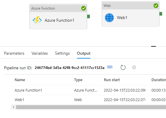

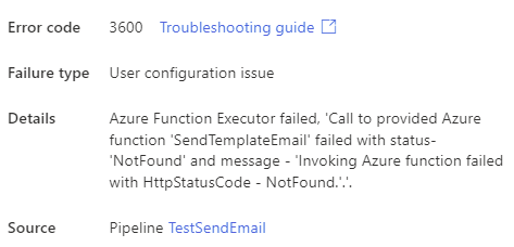

When I run the pipeline, I get the following error:

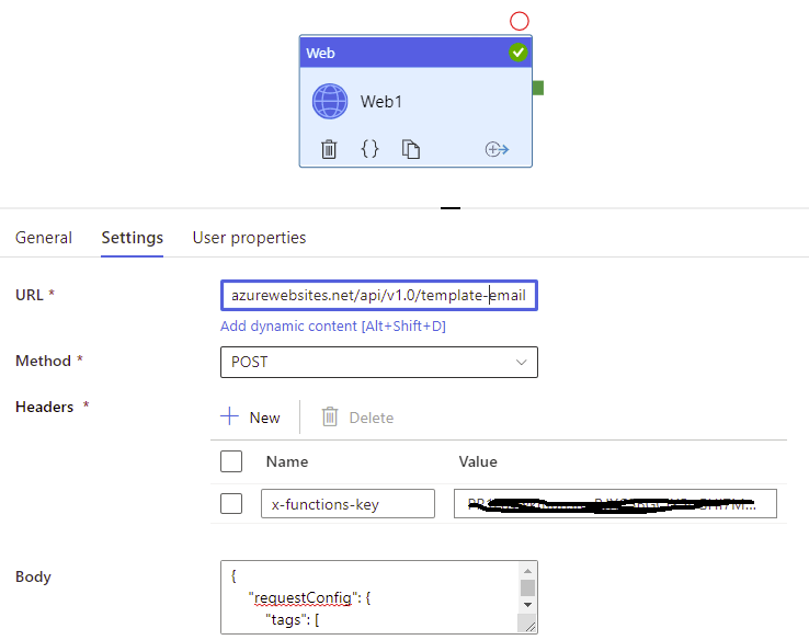

Works if using Web Task
If I make the call from the pipeline using a web task configured as follows then the call to the Azure function is successful:
Is there any way to figure out the URL the pipeline is trying to reach?
