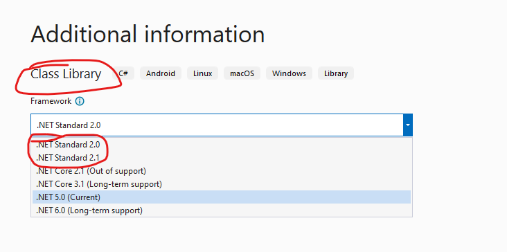

    2022-04-20T07:41:08.89+00:00
    Hi @iqworks Information Quality Works ,
    i can use .net standard to call projects between .net 4.8 and .net 5.0?
    You can create a class library with .Net Standard 2.0 or .Net Standart 2.1
    Then, in the class library, you can install the Entity Framework package, add classes and dbcontext.
    After that, in the .Net 4.8 and Asp.net 5 application, you can add the class library reference and use the relates class, method and dbcontext.
    In this scenario, the class library contains the shared classes, dbcontext and methods, if you want to call the .Net 4.8 and Asp.net 5 project's method from another project, as AgaveJoe said, you have to send the http request via HttpClient.
