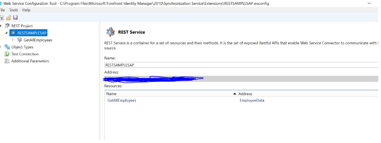

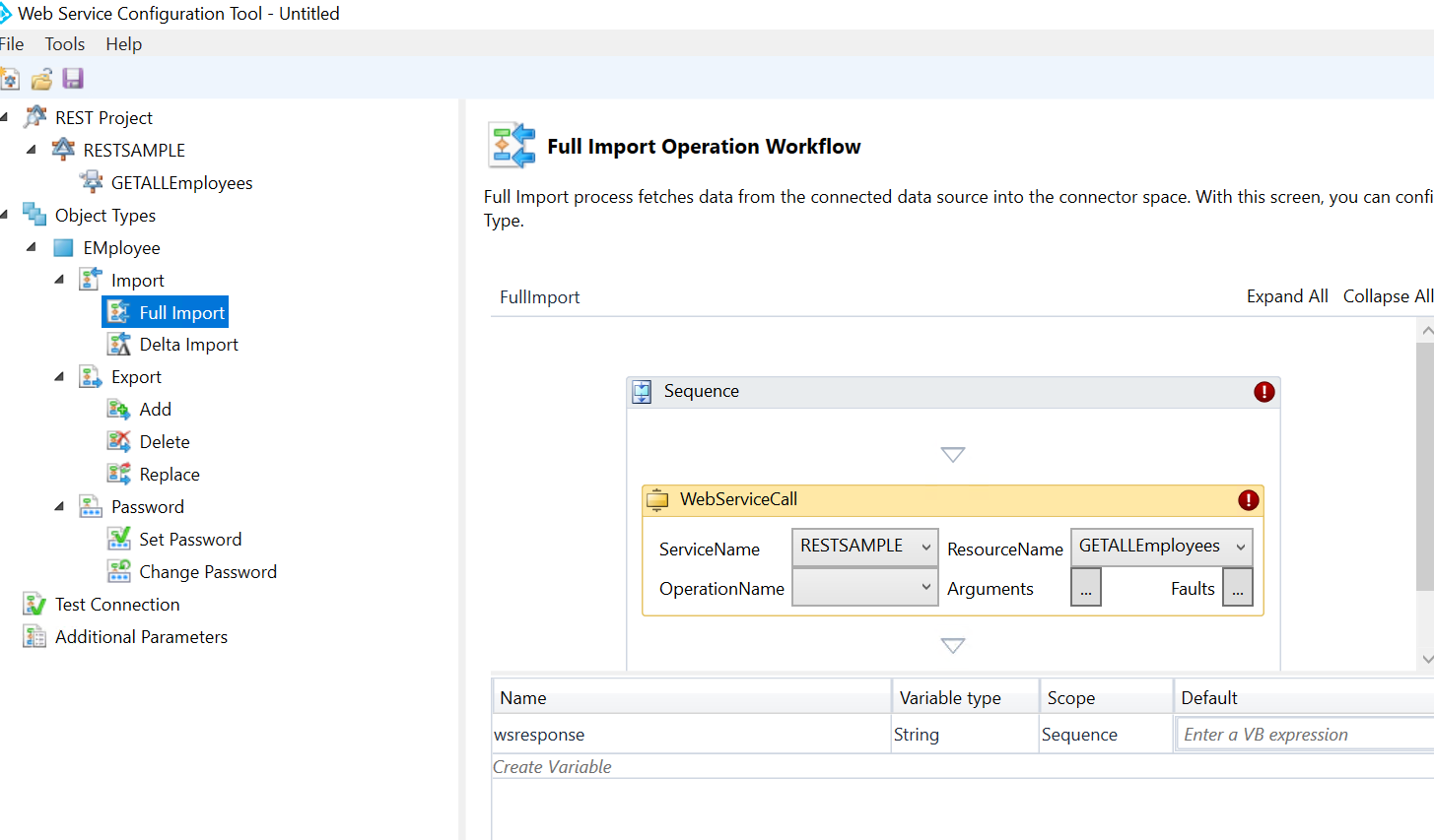

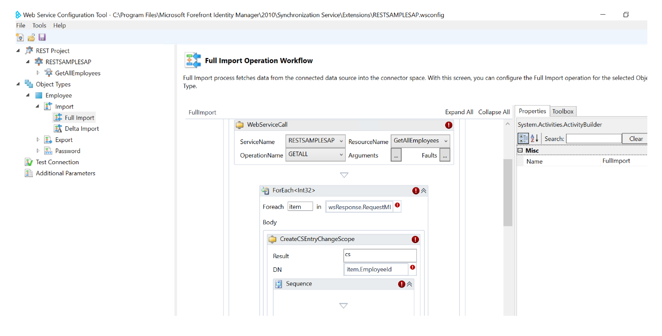

    REST API URL does works for integrating with MIM Web Service Connector
    Please help, how to integrate REST API URL with MIM Web Service connector to import the user data. i have got this below link to create REST Project file which Web service project( .WSCONFIG)
    https://learn.microsoft.com/en-us/microsoft-identity-manager/reference/microsoft-identity-manager-2016-ma-ws-restgeneric
    however i am not able to understand what i would need put REST Resource, and also dont understand the how to create workflow, for me not getting the correct data from REST API.
    please provide the link or some details step by step doc to create .WSCONFIG with import, Export workflow utilizing the REST API URL.

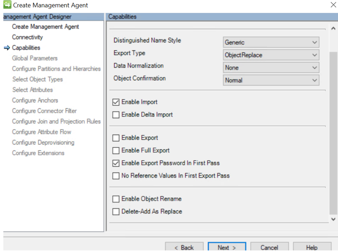

    Not sure what would need to configure here(its Web Service Connector configuration in MIM sync engine, kindly confirm,
