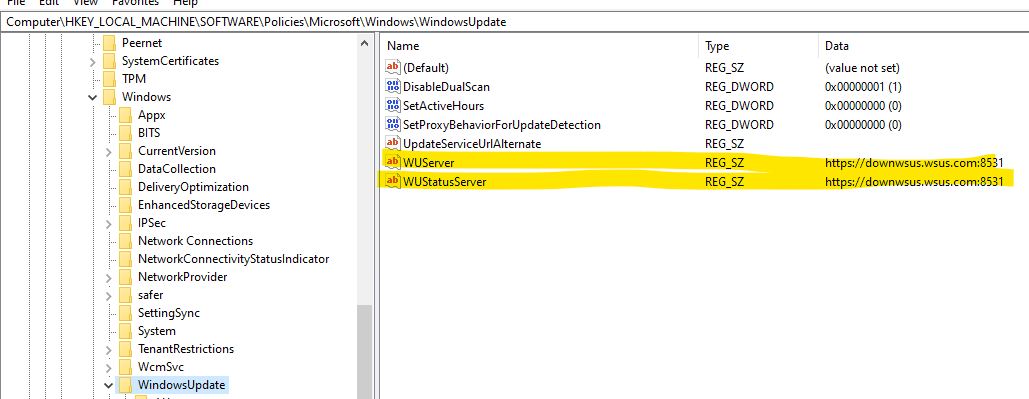

In addition, I recommended to check the following registry value and confirm the devices pointed to the right WSUS Server first.
HKEY_LOCAL_MACHINE\SOFTWARE\Policies\Microsoft\Windows\WindowsUpdate
Reference screenshot:

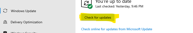

Then we could click the check for updates manually and force the device to report to the WSUS Server.
It may take some time for the device to report.

2022-04-22T14:29:53.107+00:00 Hi, I checked the registry and have the http path with port 8530 indicated. Sync completed last night but no system is listed. Ran windows update manually as suggested and took some time but now receive this error.
error: There were some problems installing updates, but we'll try again later. If you keep seeing this and want to search the web or contact support for information, this may help: (0x8024401c)
RETRY
We’ll automatically download and install updates, except on metered connections (where changes may apply). In that case, we’ll automatically download only those updates required to keep Windows running smoothly.Ran it a second time. Still working but I think I will get the same error. Should I switch to HTTPS path?
