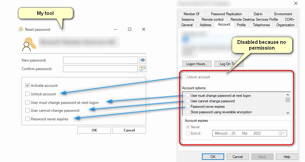

In my small tool, I give the service desk user the ability to reset user passwords from "Active Directory Users and Computer Console".
The user can also change some AD attributes.
Now I have a problem
Admin-User1 = can do everything
Admin-User2 = is not allowed to write the attribute "UserCannotChangePassword".

About "try, catch" I can intercept, but this is not a nice solution.
I would love to solve it like this: When the program starts I check if the Admin-UserX has permission on the attribute. The checkbox is then "checkbox.enable=true" else "checkbox.enable=false".
Now my question:
How can I check the permission on the Active Directoy attribute.
Thanks for your help.

    On the AD attributes all domain users (to my knowledge) have read permissions.
    The attribute "UserCannotChangePassword" can be either true or false. I can query this. But I want to query if the admin user can also write this value without changing the value.
    Unfortunately I can't say I write and if it doesn't work then Catch ... (Access Denied).
    It is about attribute permissions and not attribute values.
