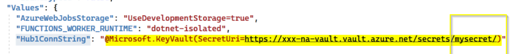

    I added this to my git: https://github.com/blucas2016/TestVaultRefOnAZFunctionV4Isolated
    try to clone and modify the value for "Hub1ConnString" to your vault's secret path

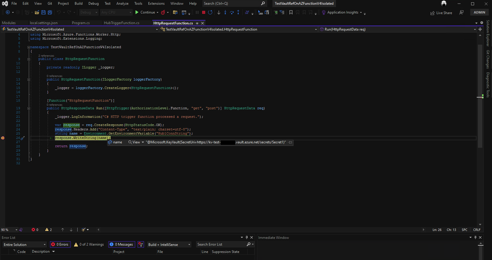

    I've added that httptrigger just because makes it easier to debug and demo the parsing of the vault reference . as you see in the debug window the value is the conn string, not the vault ref

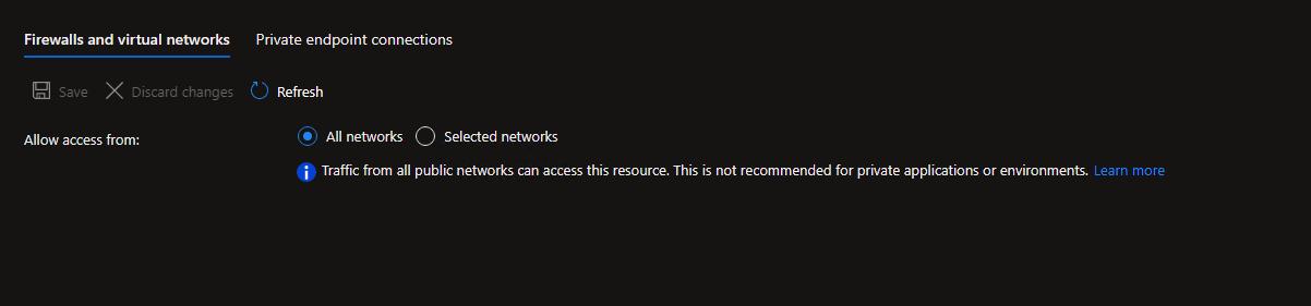

    I'm running my vs 2022 as admin:
    Sometimes it can be the firewall. But usually, firewall throws a specific error: https://brunolucas.blog/2022/02/27/code-and-test-azure-service-bus-and-azure-event-hub-triggers-locally/

    Hi @Oleksandr Kyselov
    When you say "My visual studio is running on admin mode and logged in with the azure account that has all rights necessary.", do you mean you can se the user (you are using to login into VS) has a vault policy with permission to read secrets?
    Look like you are adding the key along with the vault secret path:
    note my example does not have that key/hash part:
    try secrets/Secret1")
