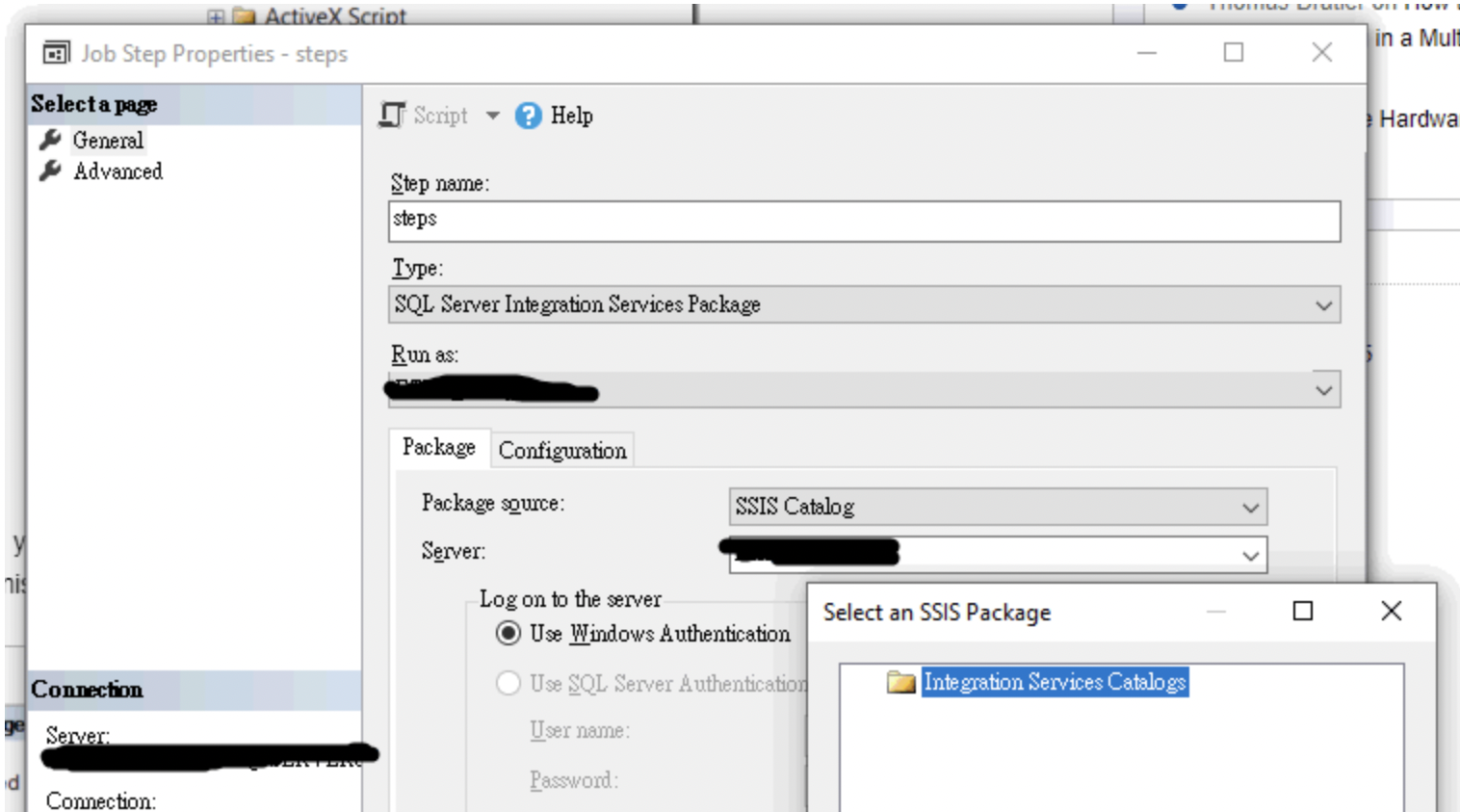

But then I encountered a problem: the deployed project/package(s) are not visible
Is there any permissions/authorities of I am missing?

  1. ZoeHui-MSFT 22,211 Reputation points
    2022-04-26T03:01:19.107+00:00
    Hi @Lam Hoi ,
    As the image shown, when you connect serverA in serverB, it is success and we could see the ssis packages in the SSISDB.
    When you configure the agent job, please make sure the server you choose is serverA.
    If I misunderstand your issue, please incorrect me.
