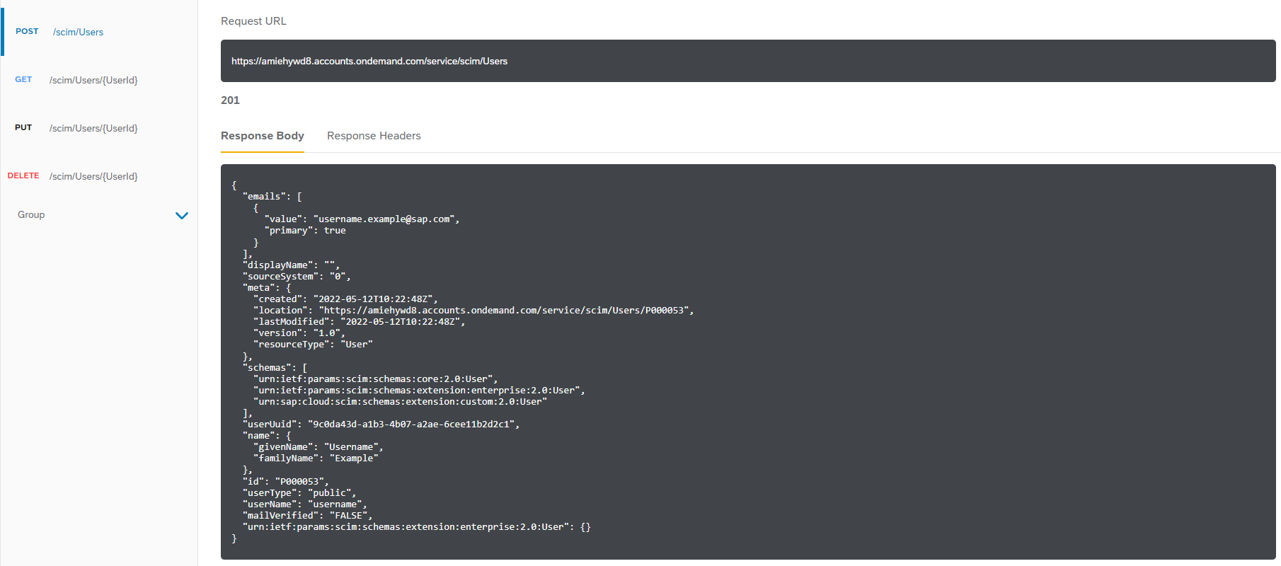

    I found the solution for my problem while researching the information for @Alfredo Revilla - Upwork Top Talent | IAM SWE SWA .
    So the problem was that there are these two APIs available for the IAS:
    • https://api.sap.com/api/IAS_SCIM (https://IAS-host/service/scim)
    • https://api.sap.com/api/IdDS_SCIM (https://IAS-host/scim)
      And the false assumption on my side was to use the .../scim that includes more information, but apparently the Azure AD can not work with it.
      So I switched to .../service/scim, and it worked (for one of both my test-users :D )
      I'll mark is as solved as soon as I can provision both users.
