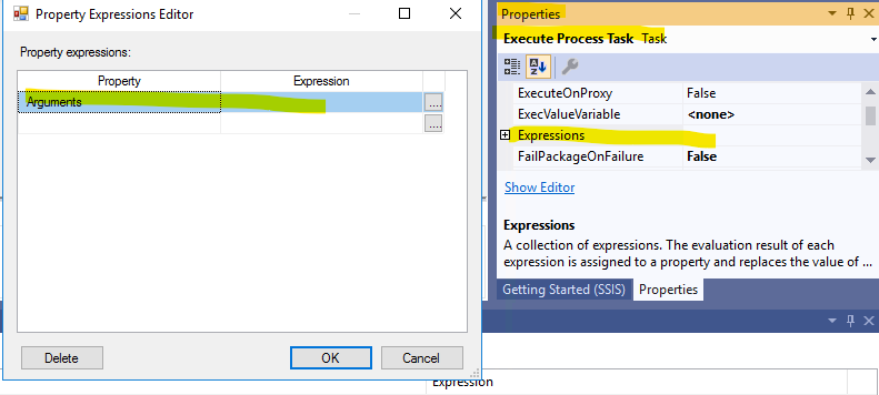

  2. ZoeHui-MSFT 41,536 Reputation points
    2022-04-29T03:01:40.057+00:00
    Hi @Victor Sotnikov ,
    You may use Property Expressions to set the parameter inside Execute Process Task.
    1.Open the Data Flow Task properties window.
    2.Click on the "..." beside the "Expressions". That will open the Property Expressions Editor.
    3.For the Property, select the Arguments
    4.For the Expression, click the "...", this will open the Expression Builder window in which you can expand the parameters node and drag and drop the parameter you want.
    use-property-expressions-in-packages
