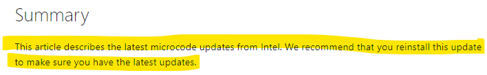

  4. Rita Hu -MSFT 9,661 Reputation points
    2022-05-09T02:08:33.48+00:00
    @MasterOfChilli
    Please try to install the latest KB4589210 Intel microcode updates for Windows 10, version 1607 and Windows Server 2016 and check whether the issue will be resolved. I tried to check for updates on my Windows Server 2016 servers and it seems that the servers missed the updates.
    Click here to get the updates.
    Best regards,
