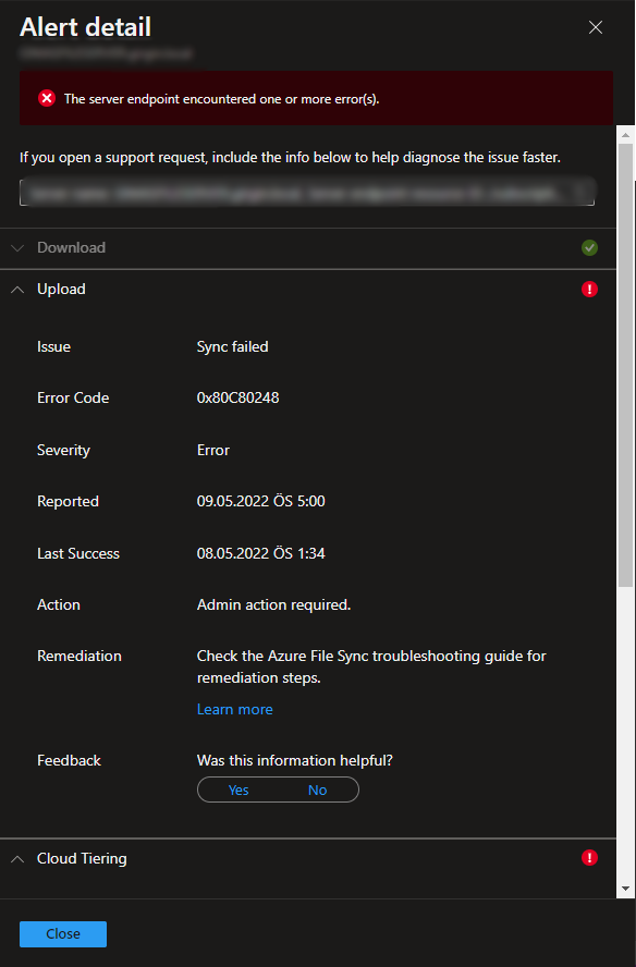

The errors on the portal are:
Download
Sync failed
Error Code
0x80071128
Upload
Sync failed
Error Code
0x80C80248
Cloud Tiering
The file failed to tier because the current sync mode is initial upload or reconciliation.
Error Code
0x80C86050

    Based on this error message: 0x80C86050 No action required. The file will be tiered once sync completes initial upload or reconciliation.
