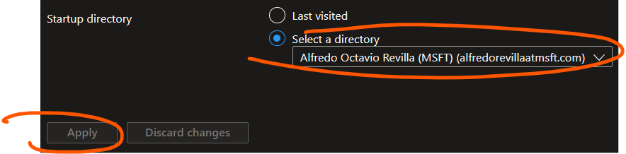

So then I decided to try to add a new tenant in AD, using mycompanyname.onmicrosoft.com as the domain. I was able to do that, and eventually changed the first domain to include the name BROKEN so I could differentiate it. I eventually figured out I had to migrate my subscription. But...
Now when I log in, I am connected to the original tenant. I can't change it, because the subscription was migrated to the new tenant. The entire operation is dead in the water.

    1) There is a "switch" button in the controls on the "manage tenants" blade I was able to use to switch to the new domain. I still cannot delete the old domain, and trying causes it to switch back.
