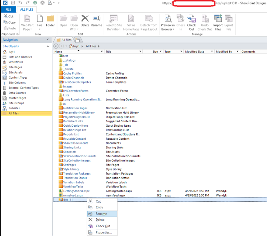

    Yes, we could change the url using SharePoint Designer: Open site > All files > select the document library and rename it

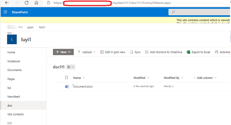

    As a result, the url has been changed from https://domain.sharepoint.com/sites/luyitest1311/doc/Forms/AllItems.aspx to https://domain.sharepoint.com/sites/luyitest1311/doc111/Forms/AllItems.aspx
