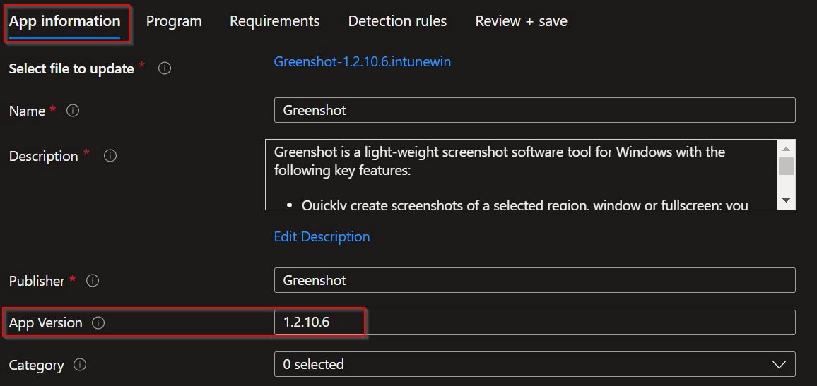

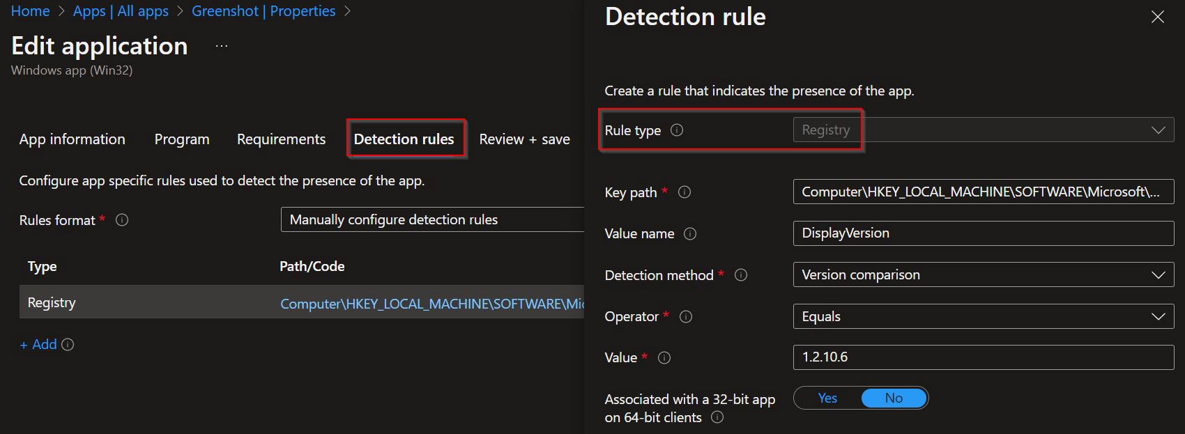

  4. Dragos Radu 0 Reputation points
    2023-04-12T03:22:03.31+00:00
    Hey Chris,
    That error is caused by the detection rule. I've been battling with the same error message while installing Greenshot trough Intune until I changed the detection rule type to Registry. See image below. Key path = Computer\HKEY_LOCAL_MACHINE\SOFTWARE\Microsoft\Windows\CurrentVersion\Uninstall\Greenshot_is1 Value name = DisplayVersion Detection method = Version Comparison Operator = Equals Value = 1.2.10.6 Greenshot version 2
    The value in my case is the version number of the Greenshot app which I configured on the App Information tab, but if you didn't configure that find the value of another reg key in the above Key path and use that for your detection rule. Greenshot version
