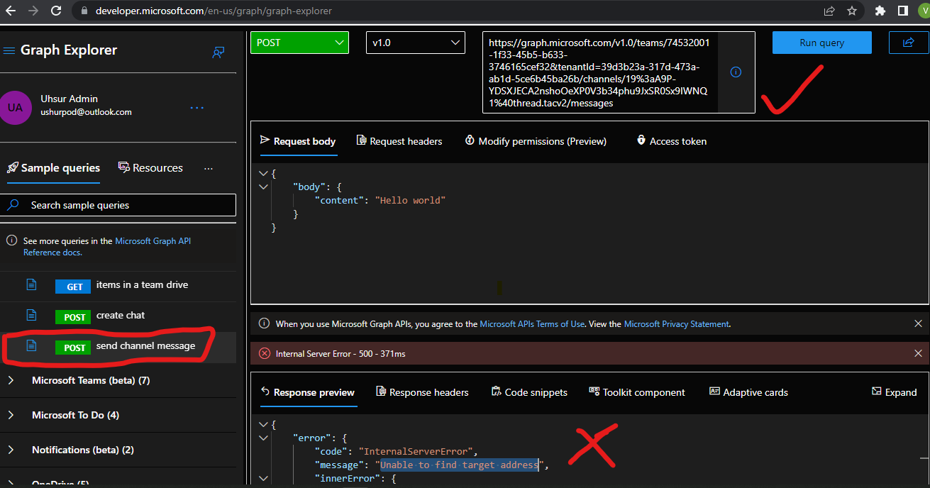

Hello there,
found similar issue here : https://learn.microsoft.com/en-us/answers/questions/568047/graph-rest-api-to-send-a-message-to-a-teams-channe.html

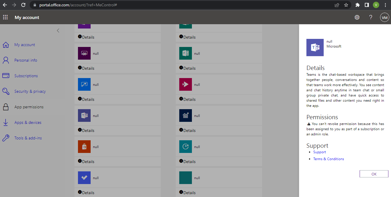

As @CarlZhao-MSFT suggested I used a Work/School account. But issue still persists. I have asked my Admin to Enable Permissions. But they could not enable it.
I have logged in with Work Account but still getting the same response. Could you please provide steps to enable these permissions? Or any other help I would be appreciate201366-graph-api-error.png201327-app-permissions-ushur-ms-account.png. Thanks much!
PS. Note : I am trying to use these APIs via Tray.io Integration Tool attached Screenshots 201375-new-ms-work-accnt-authpermissions.pngplease refer.
"error": {
"code": "InternalServerError",
"message": "Unable to find target address",
"innerError": {
"date": "2022-05-11T09:00:47",
"request-id": "e735d22d-e788-469d-afbc-954f6f60e840",
"client-request-id": "e86da880-ff14-de48-f2e6-15c94fa02a60"

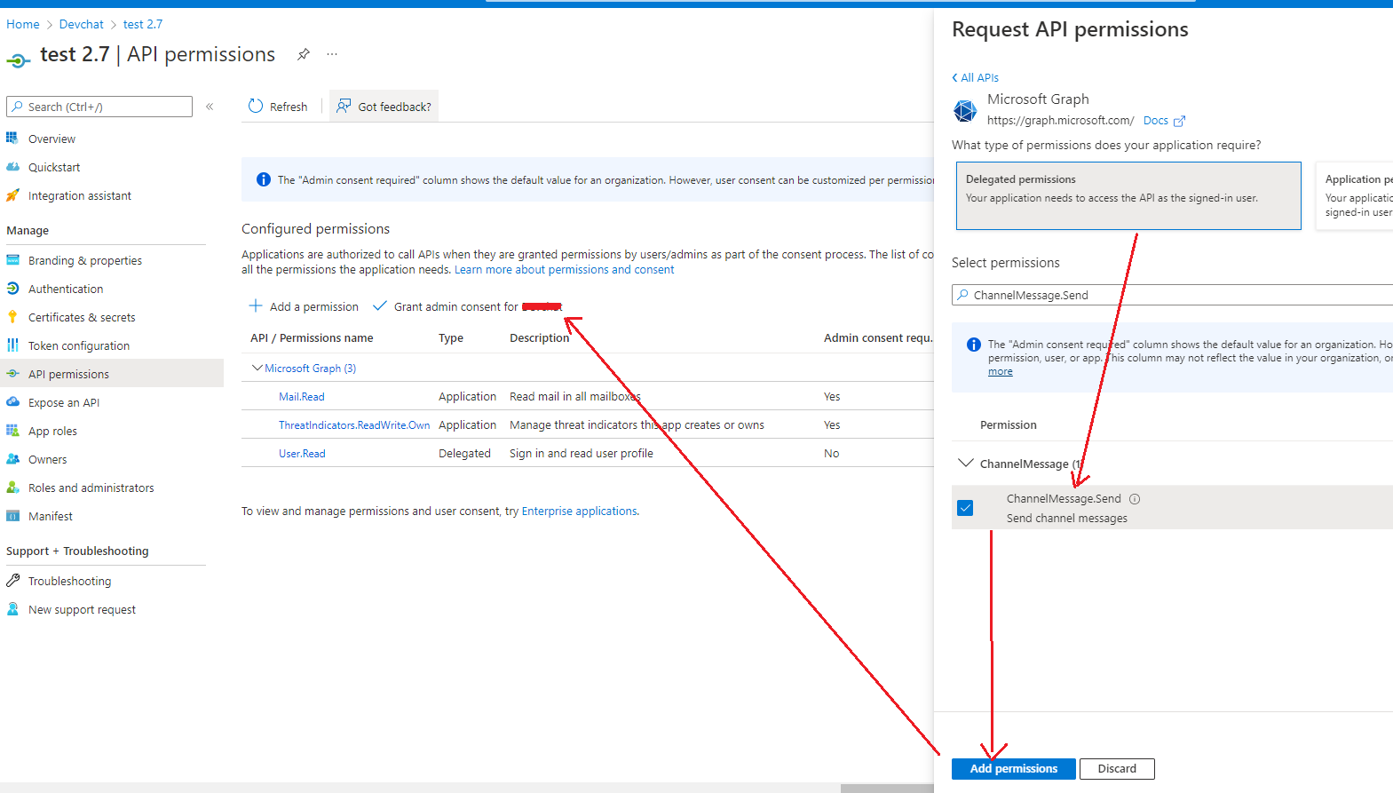

  1. CarlZhao-MSFT 46,376 Reputation points
    2022-05-17T10:19:34.62+00:00
    Hi @Vijaykanth
    First grant your application the ChannelMessage.Send delegated permission.
    Go to the Azure AD portal and log in with the global administrator>App registrations>your app>API permissions>Add a permission.
    Then use the auth code flow to get the access token:
    1.Run the URL in the browser and log in with your work account to get the authorization code.
    https://login.microsoftonline.com/{tenant id}/oauth2/v2.0/authorize?
    client_id={client id}
    &response_type=code
    &redirect_uri={redirect url}
    &response_mode=query
    &scope=ChannelMessage.Send
    &state=12345
    2.Redeem an access token with your authorization code in postman.
    Finally use the token to call the graph api endpoint to send the message.
