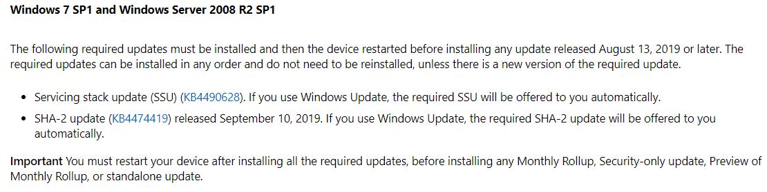

    According to the link, the error code 80092004 occurs which means that the Windows Server 2008R2 missed some important updates. Please refer to the following picture:
    It is recommended to install the following updates first and then restart the server:
    KB4490628
    KB4474419
    Reference picture:
    In addition, it is recommended to upgrade to the latest Windows Server version. The Windows Server 2008R2 is end of support.
