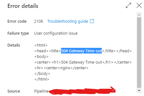

I have an azure function that was working properly till yesterday. But now I am getting this error:
I already tried increasing the HTTP request timeout from 1 min to 5 mins:
Can someone please help?

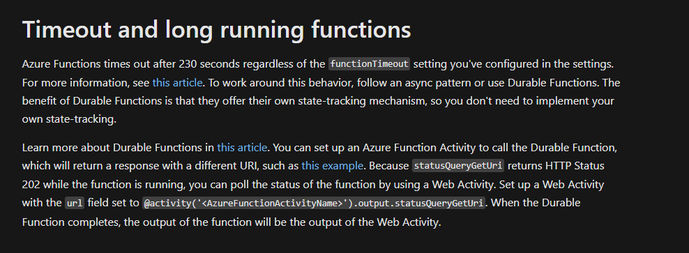

    The error `504 Gateway Time-out' usually occurs when your Azure Function takes more than 230 seconds to return a response. Azure Functions activity times out after 230 seconds regardless of the "functionTimeout" setting you've configured in the settings. In case if your Azure function takes more than 230 seconds to return a response, you may work around this behavior by following an async pattern or use Durable Functions. The benefit of Durable Functions is that they offer their own state-tracking mechanism, so you won't have to implement your own. S
    Here is the document for reference: https://learn.microsoft.com/en-us/azure/data-factory/control-flow-azure-function-activity#timeout-and-long-running-functions

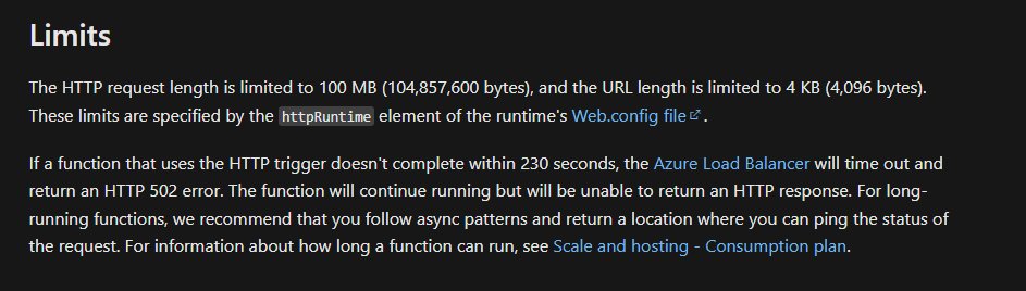

    Ref doc: https://learn.microsoft.com/en-us/azure/azure-functions/functions-bindings-http-webhook-trigger?tabs=in-process%2Cfunctionsv2&pivots=programming-language-csharp#limits
