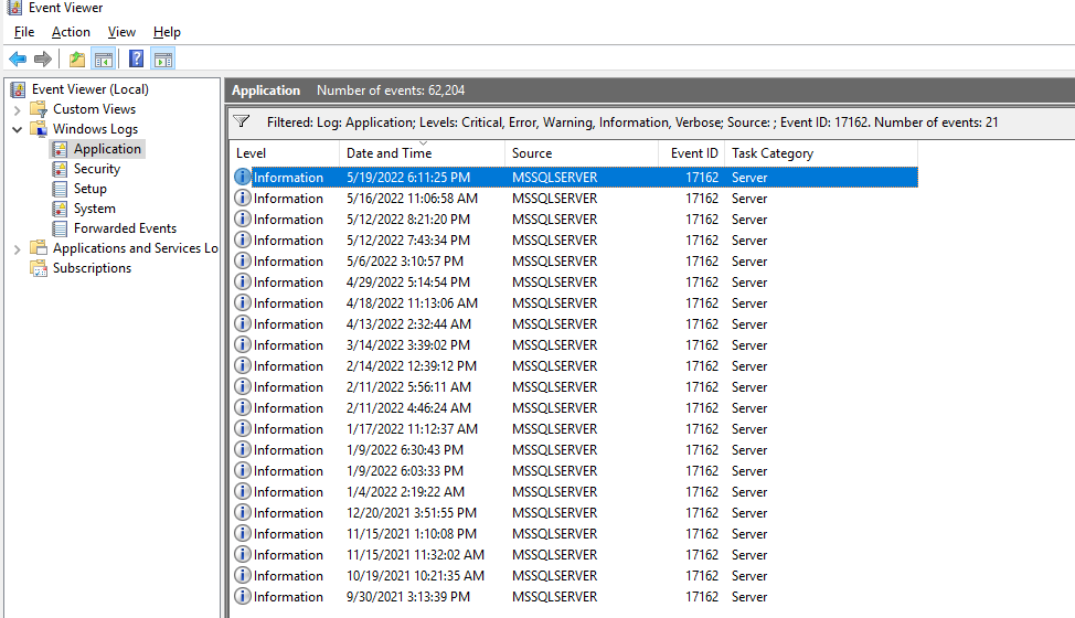

    Could you try to use the event 17162 in Windows Event.

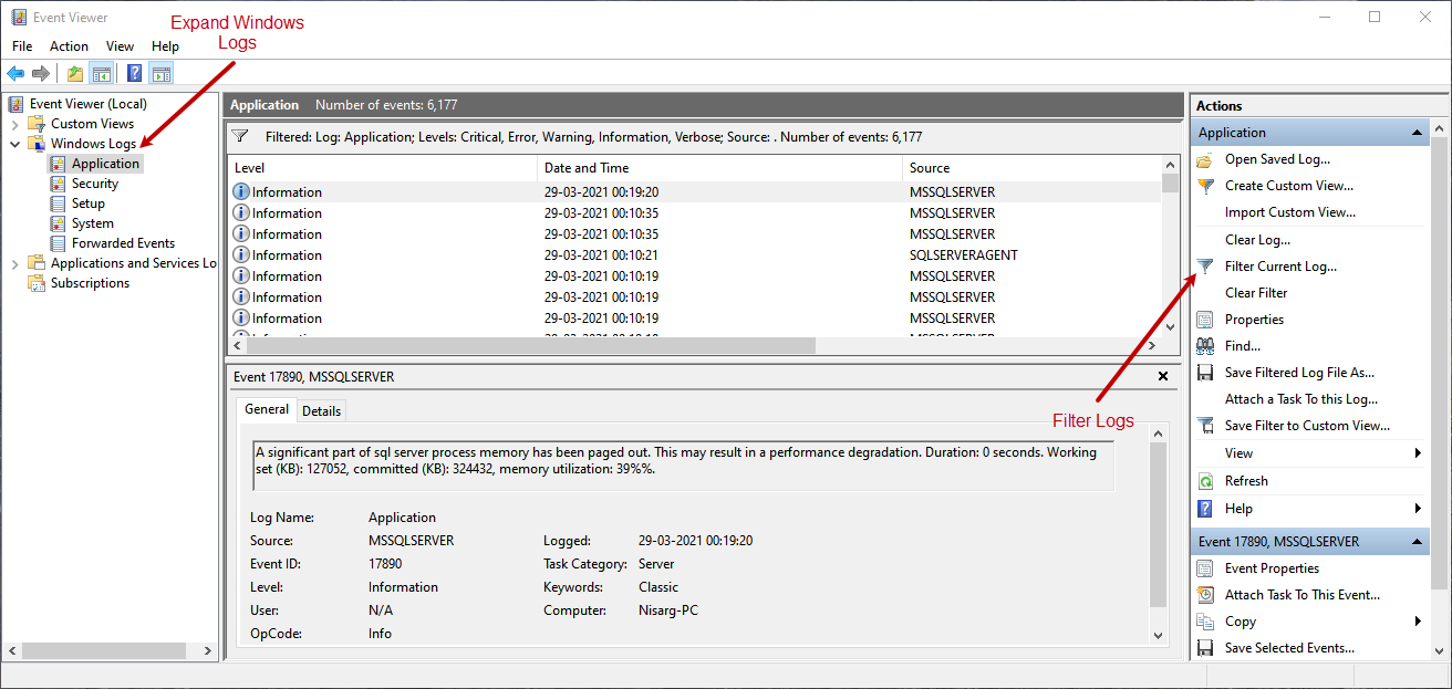

    Click on Filter current log in the right-pan of the event viewer:
    Select all event levels, specify the 17162 event ID in the event ID text box and click OK:
    Here is my result:
    And i did a test that i restarted SQL Server and refreshed it, then a new event 17162 come out.
