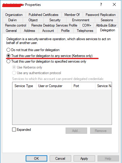

  3. CathyJi-MSFT 22,406 Reputation points Microsoft External Staff
    2020-09-04T02:41:05.757+00:00
    Hi @DeepKaur-3078,
    As Erland mentioned, your issue is typical double-hop problem. The issue is that SQL A does not pass login credentials on to SQL B. Why doesn’t SQL A pass through the credentials? Because the service account under which SQL A(middle server) is running was not configured as below screenshot. Active Directory User and Computer > User> service account >Properties > Delegation. Make sure Advanced Features are being shown, or the delegation tab will not show up.
    Please refer to below links to get more details information.
    Double-Hop Linked Servers
    How to link two SQL Server instances with Kerberos
    SQL Server: Curse Of Linked Server Security And The Fix: Pass-through Authentication
