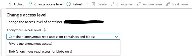

    I had a similar issue. As per the documentation in Azure, this could be because the url is invalid or inaccessible. In my case it was inaccessible and I had to open up the storage container from "private(anonymous access") to "anonymous read access". Refer to containeraccess.jpg
    Thanks,
    Anand.
