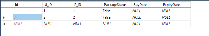

i have these tables from where first i need to find the validity column value from packages table then i need to create a trigger on every insert or update to see if the userpackges table has packagestatus column value set to true then trigger creates buy date from getdate function and expiry date from the value of validity column which is returning 90(days) so what i need to do is to add these 90 days in buydate column and store this value in expiry date
these are the tables
and this is the query i have made so far which is able to set date when packagestatus is set to true

    After I performed one update and insert action, we could have below output.
    INSERT INTO UserPackages VALUES (2,1,1,'TRUE',NULL,NULL)
    UPDATE UserPackages SET packagestatus='TRUE' WHERE P_ID=2
    select * from UserPackages
    Output:
