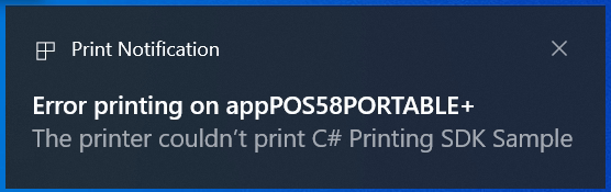

When I try to print something from the UWP app, I get this error notification:

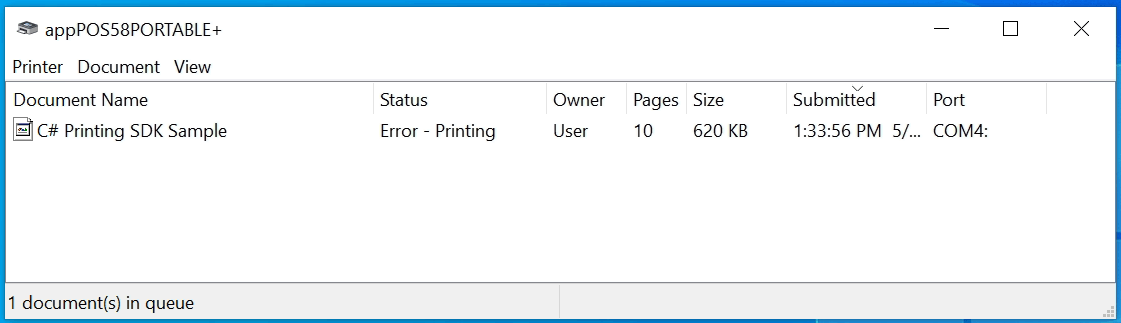

When opening the print queue, you can see that there is a document that is pending to print with an error status:

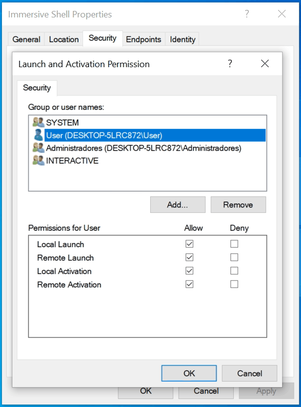

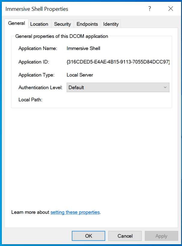

Due to this error that is recorded in the "Event Viewer", I have followed the steps of a forum where a similar case occurred (https://answers.microsoft.com/es-es/windows/forum/all/la-configuraci%C3%B3n-de-permisos-espec%C3%ADfico/d2d7d947-ad76-4069-af19-47d61be8b4ad). After following these steps, it still doesn't work. However the message changes slightly. Now instead of saying "The machine-default permission settings do not grant Local Activation permission for the COM Server application with CLSID..." it says: "The application-specific permission settings do not grant Local Activation permission for the COM Server application with CLSID...".
I am attaching screenshots of how the permissions configuration has been after following these steps:
As you can see, the user "User" that describes the error does have "Local Activation" permission.

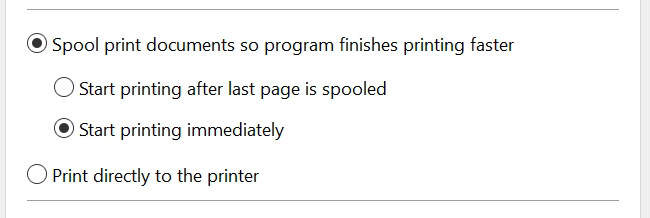

I have also tried different settings in the printer properties, like these:
but it doesn't help either
Important: if in the print queue (where the error occurs) we right click and restart on the document that has failed, the problem is "solved" and the document prints correctly. However, doing this causes errors to be logged in "Event Viewer":
In the attached image you can see that after the printing error (the DistributedCOM Warning) that I mentioned before, if you right click and restart, two new errors of source "PrintService" are registered. The first one reports that " No printers were found." and the second that "The system cannot find the file specified." even though the document prints correctly in this case.
