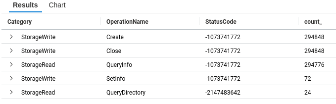

    To get all the information that are logged you can open the logs in Log Analytics Workspace as shown in the diagram below and run the KQL query.
    KQL Query:
    StorageFileLogs
    | where Protocol == "SMB" and TimeGenerated >= ago(7d) and StatusCode contains "-"
    | sort by StatusCode
