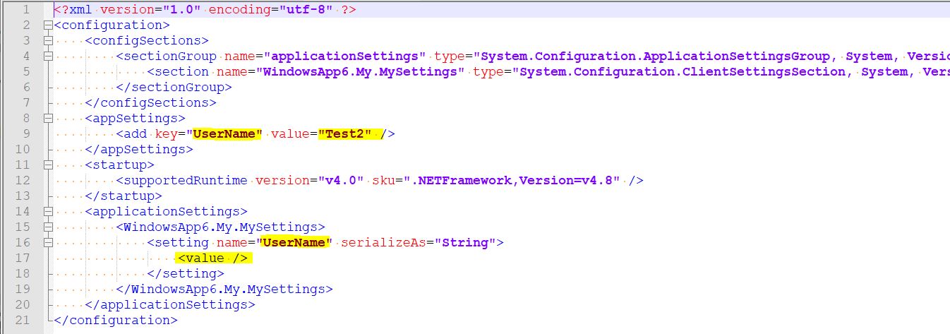

    Hi
    I can't reproduce the problem you are seeing.
    The values for the My.Settings.UserName is as expected here.
    Please check Project -> Properties -> Application -> Save My Settings on ShutDown
            '   My.Settings.Reset()
            MsgBox(My.Settings("UserName"))
            My.Settings("UserName") = "Test"

    After a lot of research, I am now able to write to the <ApplicationSettings> section of the .config file/settings per the code below however, now I have a new problem. When I run the program from the Program Files Directory, UAC is preventing me from being able to overwrite/save the changes.
    I know UAC exists for a good reason but, It's preventing my program from being able to edit it's own settings. I am using Microsoft's recommended approach for storing application settings so there must be a way to allow the program to save it's own data. I know I could run the program as admin or even use compatibility mode to run as admin but that just seems jenky! The last time I installed iTunes and changed the program configuration, I didn't have to run as admin so I really shouldn't have to do the same when I'm using Microsoft's own technology to build a program. How can I solve this problem? I am simply trying to allow my application.exe file to write to the application.exe.config file. It really seems like this should be doable without admin rights or turning off UAC. Thanks
