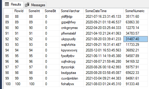

    //Query
    SELECT Top 100.* FROM dbo.RandomData TABLESAMPLE ( 100 ROWS )
