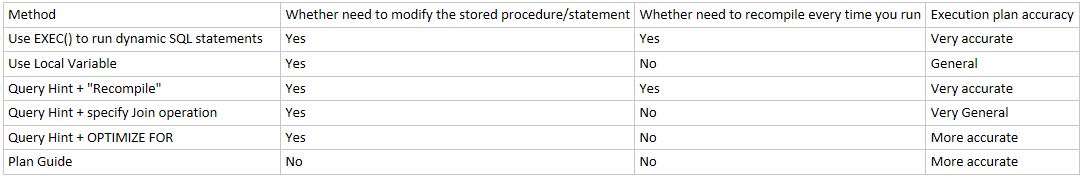

    First, let’s take a look at the following comparison list:
    For your case, let's compare the difference between using local variables and optimize for in detail:
    1.Local variables: If you assign a variable value to a local variable, SQL Server has no way to know the value of this local variable when compiling, so it will "guess" a return value based on the general distribution of the data in the table. Regardless of the value of the variable that the user substitutes when calling the stored procedure, the execution plan made is the same. And such an execution plan is generally "moderate" and will not be the optimal execution plan, but for most variable values, it will not be a poor execution plan.
    The advantage of this method is to maintain the advantages of the stored procedure,the disadvantage is to modify the stored procedure, and the execution plan is not optimal.
    2.Optimize for: The advantage of this method is that it not only allows SQL Server to make a biased execution plan, but also ensures the freedom of SQL Server to choose the execution plan, so the execution plan obtained is generally better. The disadvantage is that if the data distribution in the table changes, for example, the user deletes all the records one day,the execution plan selected by SQL Server may not continue to be correct, so it also has its limitations.
    Therefore, in short, there is no best solution, only the most suitable solution can be selected according to the actual situation.
