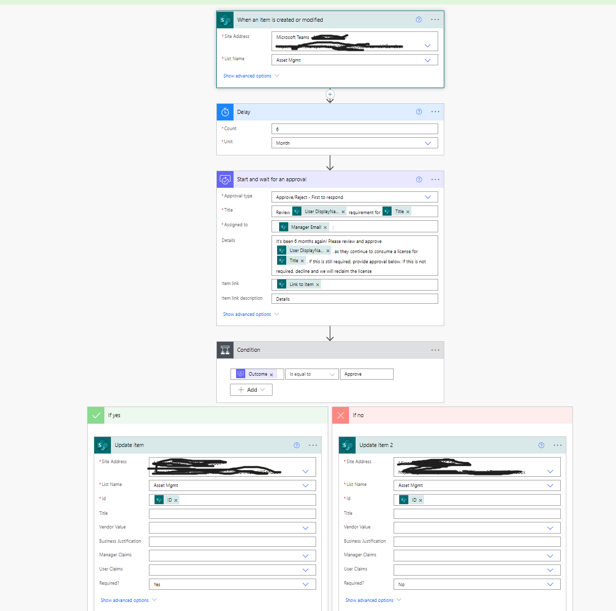

    Based on my assumptions and exposure to similar process it might be best to consider a workflow on a schedule vs manual kick off. Less hands on. Then you could build in notifications based on process breaches or certain conditions. You'll want to track process status in case one of your actors is non-responsive (or is no longer in that role).
    Have you considered your technology options? Thoughts about power apps? Thoughts about Teams? Or SharePoint/email/power automate all we got to work with here? (If so, why? :) )
1 additional answer

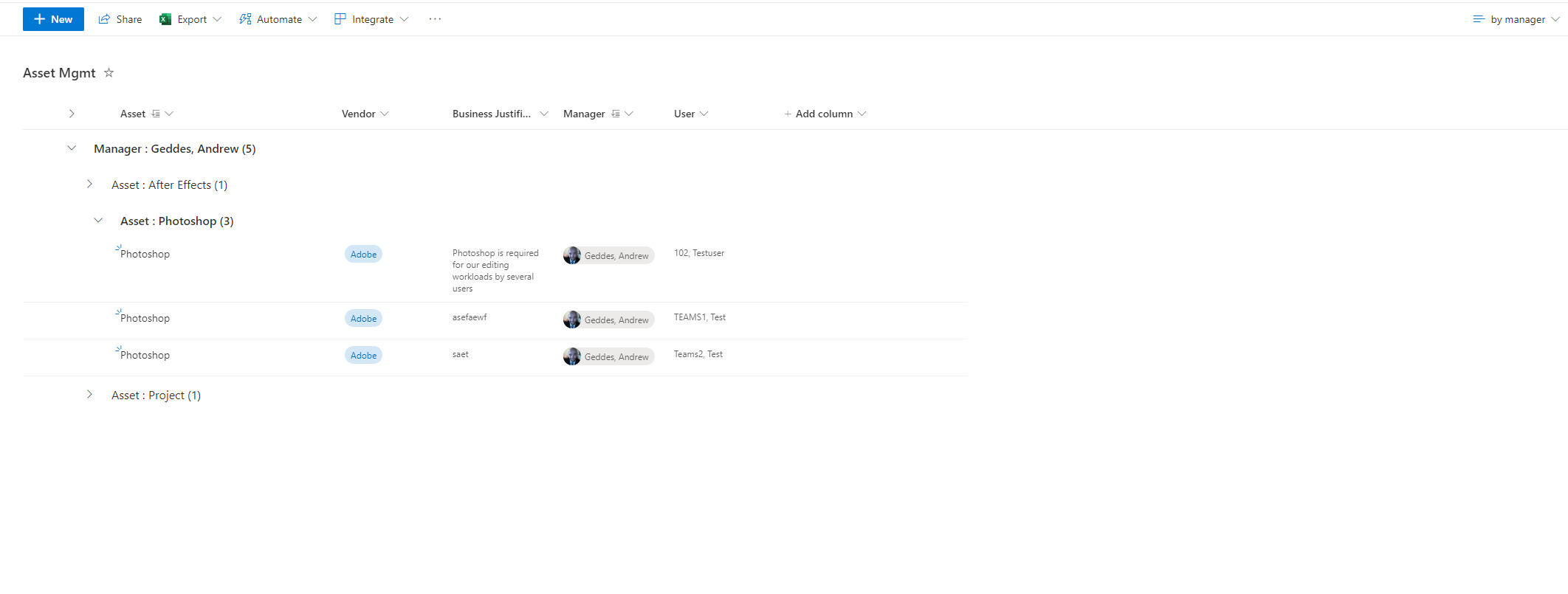

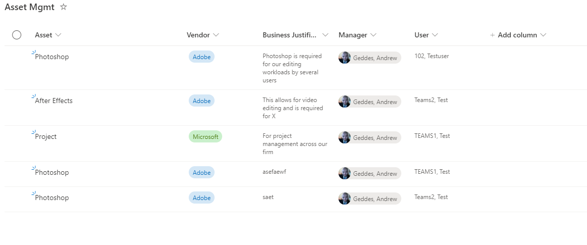

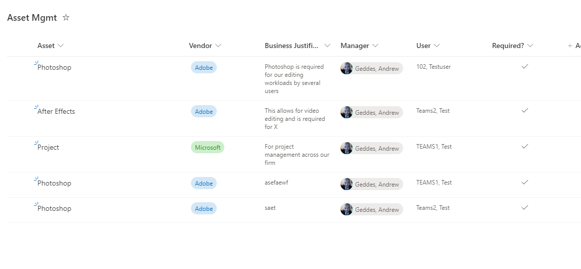

  1. Andrew Geddes 751 Reputation points
    2022-06-02T00:15:35.503+00:00
    A few things - since you're leveraging power automate, you have the ability to personalize the email, providing a list of assets to the manager via email, with link to each in list (you'd probably link them to a form in this case; alternatively provide the action buttons in email to avoid clicks)
    You could do this on a schedule which frees up the process managing party to just monitor.

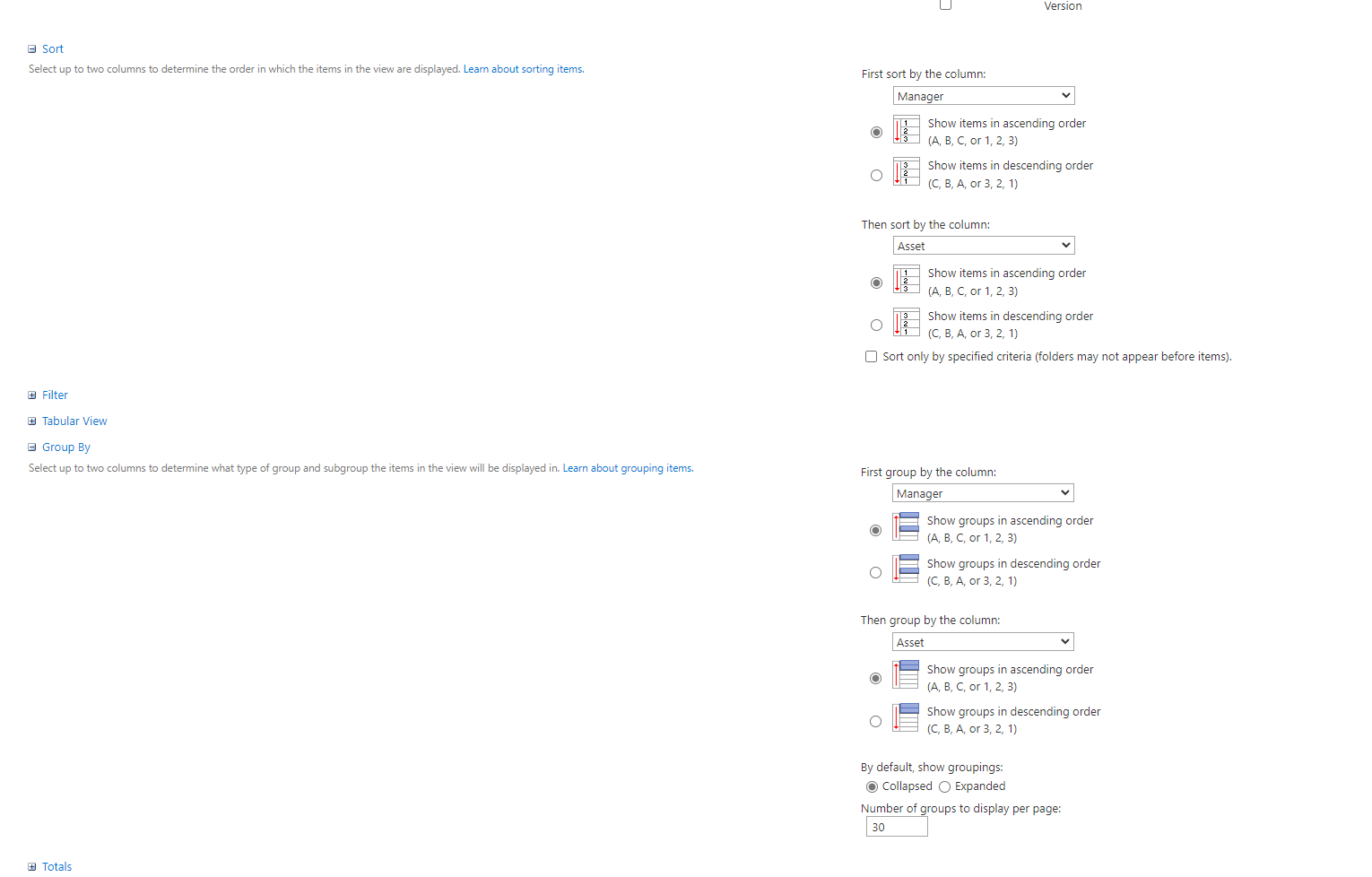

    If that isn't viable, there is a notion of filtering by "me" in a SharePoint list. You would associate the field assigning the manager to the filter of "me" and have that as the linked-to view in the email being distributed. You'll still want all items view for the process manager, so ensure it's a separate view.
