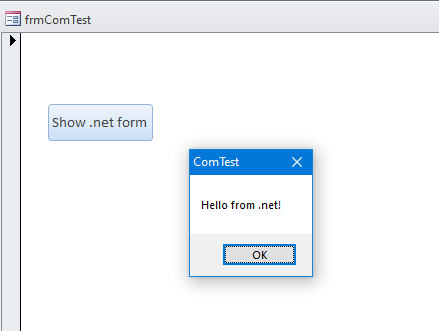

    so, when I run, the first method (Hello world runs), and I see this in ms-access.

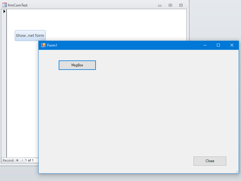

    And then ok, and then the next method (to display .net form as dialog) then shows.
    And all of the buttons, and UI on that form - even as dialog shows.
    And if I close form, then VBA code continues and we are done.
