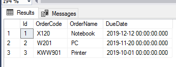

    Although it can be implemented with TSQL, the official documentation also points out that this is risky, here is my code, please try:
    CREATE TABLE TestOrderList
    Id INT PRIMARY KEY IDENTITY(1, 1),
    OrderCode VARCHAR(100),
    OrderName VARCHAR(100), DueDate DATETIME
    INSERT INTO  TestOrderList
    VALUES
    ( 'X120', 'Notebook', '20191212' ),
    ( 'W201', 'PC', '20191120' ),
    ( 'KWW901', 'Printer', '20191001' )
    GO
    SELECT * FROM TestOrderList
    DECLARE @RetVal AS INT
    EXEC @RetVal=sp_rename 'dbo.TestOrderList', 'mysimple'
    SELECT @RetVal AS ReturnValue
    select *from simple
    Previous table--dbo.TestOrderList:
      New Table----simple:
