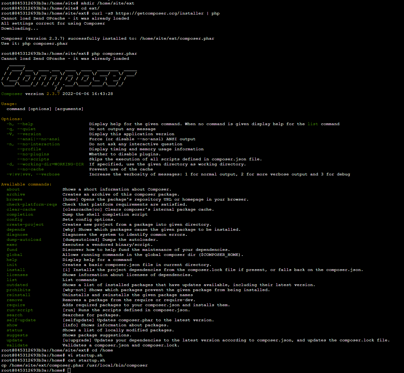

    However, once you're SSH'd into your app service:
    1. Create an ext directory inside /home/site and download composer into that directory: mkdir /home/site/ext cd /home/site/ext curl -sS https://getcomposer.org/installer | php
    2. Once installed, you can run it locally but to access globally, it needs to be added into /usr/local/bin/composer during app startup. To do that, create startup.sh under /home using vi startup.sh (press "i") and add cp /home/site/ext/composer.phar /usr/local/bin/composer and save (press "Esc" then ":wq!")
    3. Change the Configuration > General Settings Startup Command to /home/startup.sh
